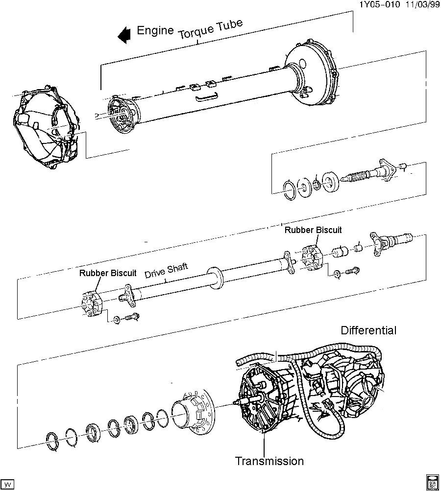

Rather than looking toward the front engined Porsche's MD, how about looking at the rear TA Corvette's?
Lol, 'Rubber Biscuit'
- c5-driveline.jpg (165.88 KiB) Viewed 10689 times
Re: driveshaft conversion
Naah. That's just an Alfa shaft with a big French Letter over it.

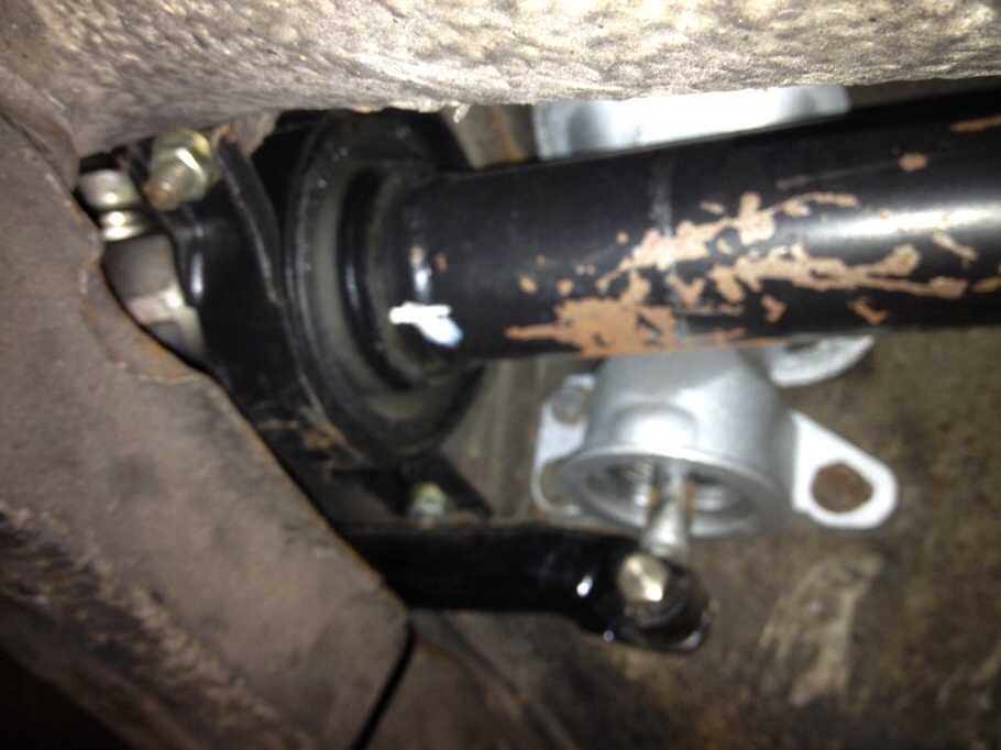

- image.jpg (134 KiB) Viewed 10236 times
- image.jpg (156.75 KiB) Viewed 10236 times
- image.jpg (210.48 KiB) Viewed 10236 times

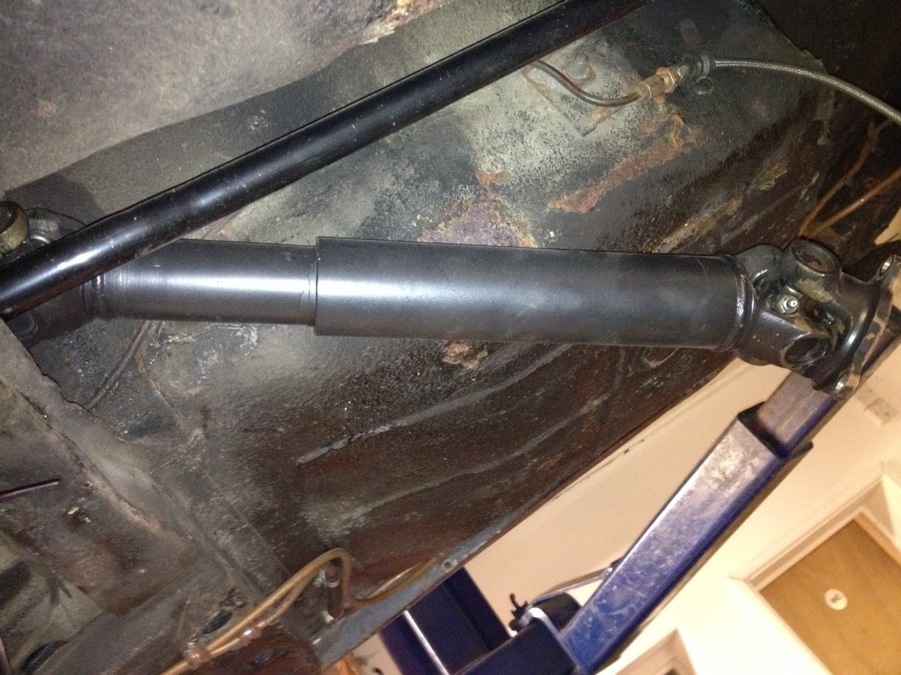

MD , I get my prop back this week . Even though its a short prop of 855mm long it will be nearly identical to the rear section as in the transaxle pic above . I will find out how they balance it and get all the specs on type of GKN joints . As mentioned they us this on the lemans Aston Martins which is a much thicker torque resilient tube to handle 1000hp . These TRT's come in different sizes and differ in number of rubber strips inside them . Its also a design used on the Westfield cars as well .
Pic attached of my old bad design prop next to an Aston Martin prop .
- image.jpg (213.74 KiB) Viewed 10063 times
