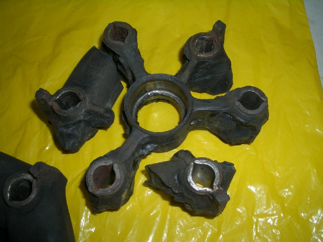

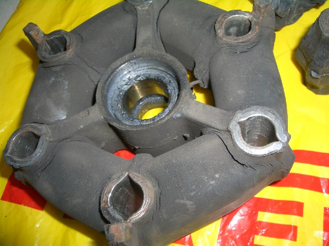

- 3.JPG (67.05 KiB) Viewed 12931 times
- 1.JPG (86.26 KiB) Viewed 12932 times
Dat's a great picture. I suppose those lugs linked together by the 3-prong spider is not likely to flare...it's the other 3 lugs that are apparelty held together by rubber in a floating manner. Quite apparent from the rubber cracks developed at the flanges of the spider.

Believe me the three bolts will deflect.
Only I don't know what is worse, the engine torque or the rpm.
The rubber bits have a real hard life, between the bolts they are buckled by the torque and forced to fly out by the rpm.

Yesterday I saw my friend's 115 GTV's donut blow up. It destroyed the spider/yoke. Totally skewed. Wow! I never thought the thick spider/yoke would bend. My mechanic warned me about it but I always thought he was exaggerating.....
And that was on a 105/115 which driveshaft spins slower than a transaxle car....
