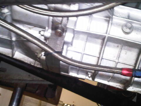

Installed the transaxle oil cooler.
Heat exchanger with ducting:
Overview:
A 0.06mm filter is fitted with a magnet inside.
The fully controlable thermostat:
Overview:
