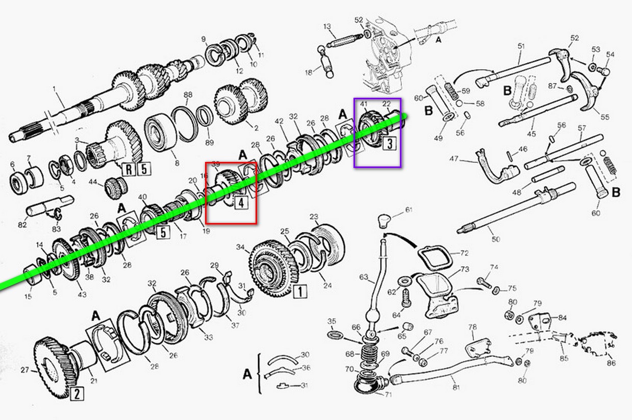

How many have swapped out the 3rd gear in the twin spark gearbox, coupled the gearbox to a boosted engine and found the shaft on that gearset spinning ?
3-4 gear set.jpg (215.07 KiB) Viewed 3149 times

I will ask the “team” . Did this happen on GTV supercharge
Re: Headspin
Yes the unresolved issues remains on the supercharged Alfetta GTV.

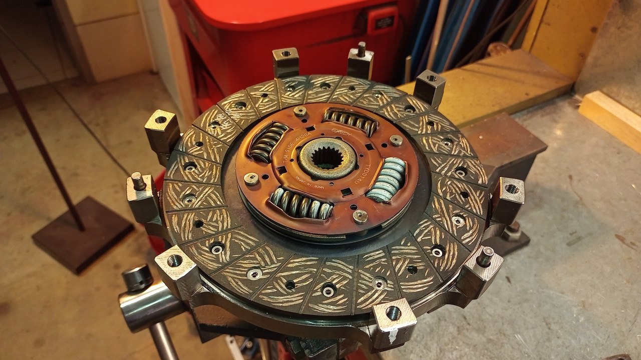

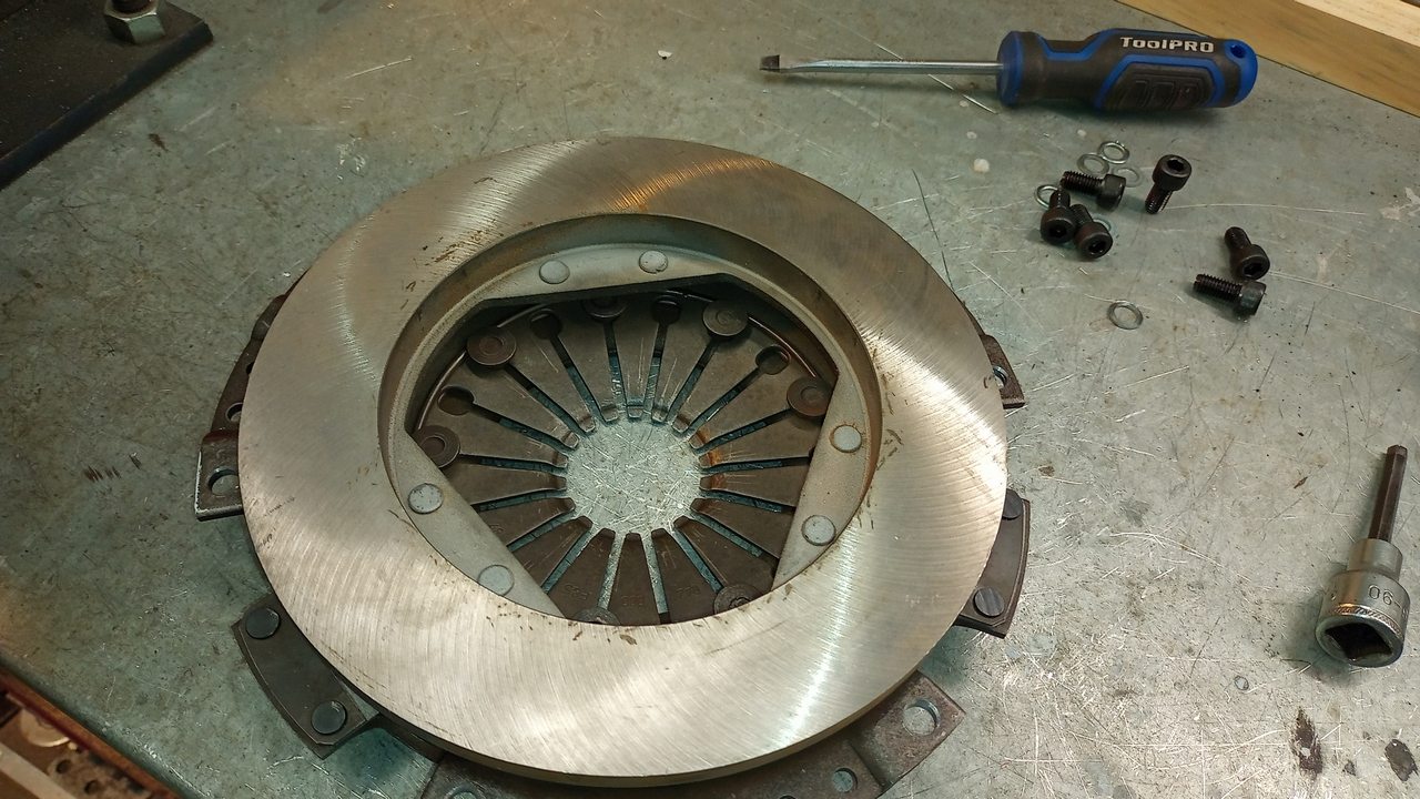

All sorted.
It was never the gear set.
Turned out to be wrong clutch compilations. Got the right sucker in now. All good.
Organic facings.jpg (248.01 KiB) Viewed 2556 times
More area and more pressure.jpg (243.83 KiB) Viewed 2556 times
