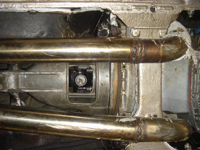

this is the front cross on my shaft , recently replaced after been torn apart... ,the mid section of the driveshaft is the BMW donut .
Chen S
ex Giulietta 24V Glenwood TT.
