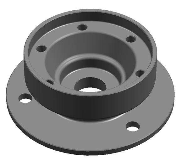

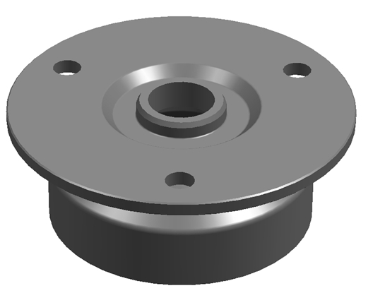

I actually just finished my first design proposal för the front CVJ-adapter, A bit on the heavy side but easy to manufacture.
Flywheel side
Flywheel side
joint side
joint side

Mats wrote:Welcome!
Interesting power level, how will you keep the gearbox from breaking?

Mats,
By the look of your adapter plus the CV joints I bet it would take just a little weight shaved from the flywheel to maintain the stock rotational inertia. If you wanted to reduce the rotational inertia you would end up needing to go with the aluminum flywheel and clutch flywheel(if anyone makes one)
Maybe a wash for performance(on a street car), but a boon for reliability(on a race car). Also a solution to the waning supply of rubber biscuts(on any car).
Good on ya Mats :D :D
Re: driveshaft conversion
My flywheel is lightened 3Kg (or ~38%). Looking at inertia; the weight taken off is at the very edge of the flywheel so the radius is large, the weight added (calculated the adapter to 1374g) is in the very center of the flywheel and therefore does not add any significant amount of inertia.
But yes, the CV joint solution is a quite heavy solution in terms of total mass, at least this disc type.
We are thinking the same on the inertia.
How about making the adapter out of aluminium? Or was that the original plan?
No, that is not in line with my "I love my feet" strategy. :)
If they were possible to make out of alu they would be on all cars, the weight saving trends of today are quite insane (in a good way) but the flanges are still steel.
