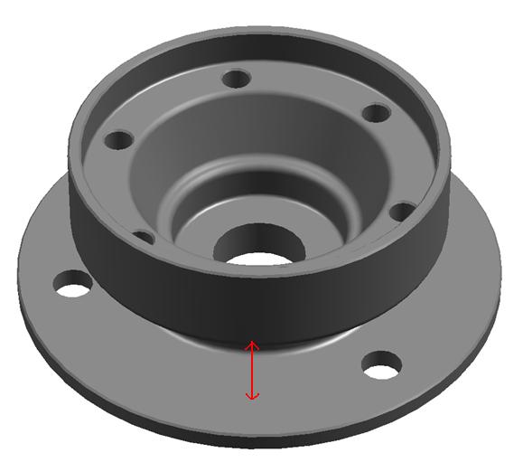

Post by PietereQ »
Thanks Mats. I have one question though, what is the distance between the flywhell side flange and the cvj flange? I hope pic will clear a bit what I mean:
Kopia medbringare1.jpg (21.16 KiB) Viewed 7155 times
Re: driveshaft conversion
I can post a drawing after I have verified that it actually works. How does that sound?
