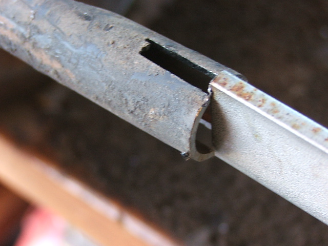

Part Two
More details of mods to shifter..
006Relocation of pivot tube.JPG (113.07 KiB) Viewed 19504 times
004Insert stainless section.JPG (114.53 KiB) Viewed 19507 times
003Relocated pivot fork.JPG (116.99 KiB) Viewed 19507 times
002Selector fork.JPG (115.72 KiB) Viewed 19506 times
001Extension to btm of selector.JPG (115.72 KiB) Viewed 19505 times
Final Part
A comparison of the original "front section" and the modified one.
(The rod welded to the shifter above the ball joint was an experiment to brace up what I consider too much spring in the selector itself owing to it relatively small diameter but this is just personal point and has no bearing on the nature of the shift geometry. Anortherwords, just ignore it.)
012New and Old comparison.JPG (118.06 KiB) Viewed 19502 times

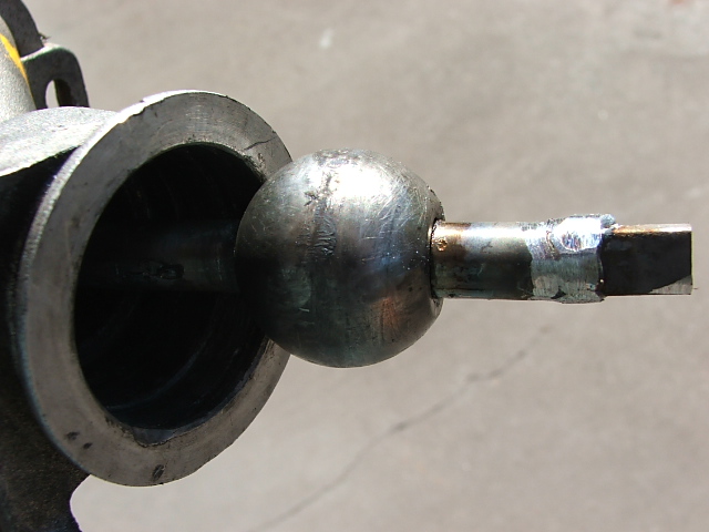

I started going a similar way to this.
I pressed the ball up 25mm on the lever and tacked it in place and then cut the shifter mount out of the trans tunnel and lifted it up so that the linkage still cleared everything. Lever top stays in the same position but the lever ratio changes from about 7.5:1 to about 4:1. I still need to change the gearbox end of the linkage (as Mike did) to reduce the lateral distance between the gates.

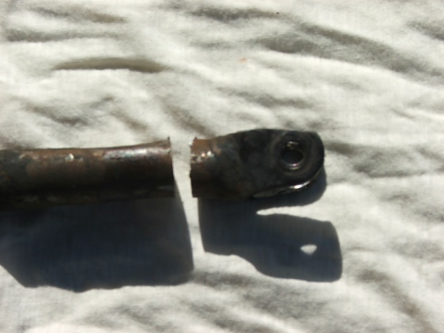

For your answer, go to page one of this topic. If you need more info, just ask. As for the isostatic assembly, it breaks the fundamental rule of engineering which is : the fewer the moving parts, the greater the reliability. Can't beat the reliability and simplicity of the original changer.
A combination of Daniels stick (pivot) (ball) changes and my mods to the rear crank should get you shifting short and precise.

ok so I presume that last photo is the final crank to the gearbox? Sorry not been under the car yet to have a good poke around, and familiarise myself with the rear half, but its something Im looking at modifying. So reliability asides, I take it the later iso shift is not much of an improvement, and is still fairly sloppy. I drove a late 75 with this system, and to be honest apart from the shorter shifting, it didnt seem much better than the original system in good condition. The combination of yours and daniels mods, look like a nice improvement for almost no cost.
thanks chaps.

mjr,
I'm not sure if the centre console will fit - I haven't got to re-fitting the interior yet. When I do, I think fitting the dash around the cage will create more of a problem than the console. I will check the console this weekend and post a pic.
