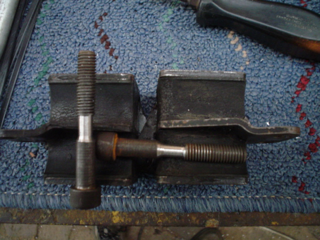

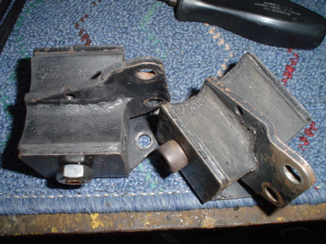

:roll: Ok,Tested these mounts untill I bled....I cannot get rid of the vibe above 3500 rpm...

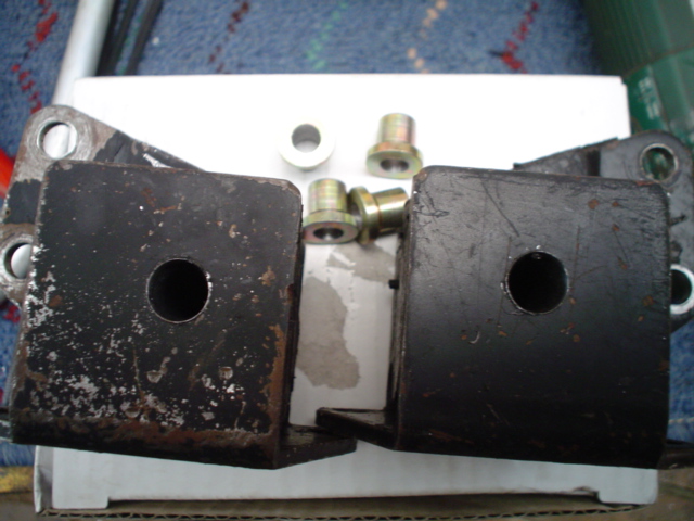

Made new ones following Mikes suggestion...
Ive made the through holes 12mm..Where yhe center plate is moulded Ive undercut the bolts to around 8mm..this will give a bit of flex and movement(hopefully enough to cancell the vibrations..)before it goes solid and holds everything in place....time will tell.
Will fit them to the car am...
That sure looks like it will work. It seems to me that the first design should work, perhaps softer rubber would solve the vibration. In any case this second version with a bolt through the original type mount should be just fine.
Greg,Once I know what works well,Ill make something final..I hope its not ver. 10.01.13 !!
A load of work to change them everytime..The first ones were typical of my old race car....vibrations high up the rev range...
I think the idea here is emulate the std mounting without the "stretch" on the rubber..If ver.2 works,ive got the final idea already... :!:

Fitted the upgraded ver2 mounts yesterday..Bingo!!As smooth as a baby`s butt..no more vibes,no more zing..
Greg has probably hit the nail onthe head with the same "squishiness"thing..This has proven one thing,the mounts play a much more important role than just keeping things together..
Ive inspected the old modified mount and will make version 2 of that with a few changes..I think it was way too solid...
That will then get tested in the ol Giulietta later..
Product review??Anyone wanting a cheap and efficient method,go for ver 2 as above...they should also last much longer... :idea:

Well today after 5 months i have test driven my gtv6, and I'm sorry to say that, mount reinforcement didnt work with my car. I have used "Barry style" reinforcement with material grinded off the bolt in it's central section. I had terrible vibration form 2,5K rpm and on deceleration regardless of rpm. Got rid of the bolts and it's smooth as never was. These are brand new mounts, so I'm left with hope that they will last few seasons.
Re: Tired of replacing box mounts??-Barry
I have done this four times, on four different cars with 100% success, so there is some variable here causing the vibration.
Jes also had a vibration issue, so there is some variable that comes up, but the basic concept is sound.
Greg Gordon,
www.hiperformancestore.com
I think there might be a difference in how you drill the holes through the rubber...
I was looking into this mod and wondered how i could do it best when i realized that the amount of "free play?" around the bolt was not very much. the difference with or without weight applied to the mounts might cause the bolts to touch the other part and cause a vibration.
I drilled the holes while the gearbox mounts were fitted to a spare triangle holding a spare gearbox. this way the mounts are loaded with the weight of the gearbox as they would be under the car. I never had a problem with it this way.
