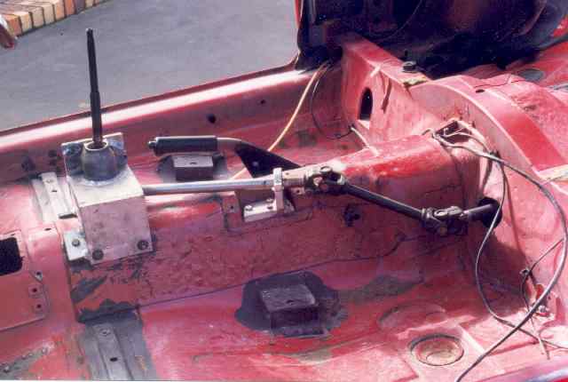

...and here is the actual selector shaft components themselves. The stainless steel hydraulic tube which is tough AND RIGID, courtesy of Daniel.
Man, that guy knows transaxles..
The mini universal joints are ex VolksWagen steering column.
The bearings are "Plumber's Blocks".
Have fun...

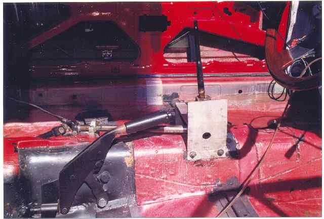

If you are thinking along these lines, it doesn't work very well. Wants to balk second gear. Used it for a while but abandoned it for a completely different set up. I can see the obvious faults now that I have gone through all the changes but as my first attempt, I was just hoping for the best..u-joint off the input to a 45 deg angle to the tunnel then another u-joint 45 deg to square it with the tunnel on top of the tunnel
Note the relocated handbrake to be able to do this. This was a bonus. It's the first handbrake on a GTV that actually works (well).

yeah thats more or less what i was thinking in my head...seeing it in place i can understand its faults...funny how thinks work in the brain but dont work as smooth always when actualy built...course building some of our ideas is half the fun isnt it?
