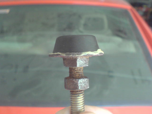

Well didn't know where to put this, but since it's continuation of tranny height store here it goes...
Despite lower mounts, rear guibo did hit the floorpan :? I guess this was the "vibration" at high speeds (190-200km/h) As you can see I'm missing the rubber part of the bump stop. I've made a new one. Now with rubber tip, it protrudes 3cm above the floorpan. Is it enough, or should i add let's say one cm more?

something not right there :shock: , rear guibo should never hit the floorpan at any speed or acceleration, maybe your missing snubber was allowing it too ride up too far, but the front box mounts shouldn't allow that much movement. the tranny shouldn't be touching the snubber for any more than a moment under hard acceleration anyway. the gap between top of tranny and snubber on my car, after correct front mounts is no more than a 2mm static. are you sure you have the correct rear guibo installed, and gtv6 mounts, rather than Milano/75 mounts? post a picture of the whole rear guibo and tranny spider area if you can, lets have a look.

Mjr, mind you those damage was caused with those tiny alfetta mounts. So far the car is still on jacks, and I havent put the new gearbox (failed to find a TS tranny, but got a 75 2,5 - no lsd but at least the same final ratio). Noticed that snubber can be easily adjusted from inside of the car, so no problem. We'll see once everything's hooked up...
