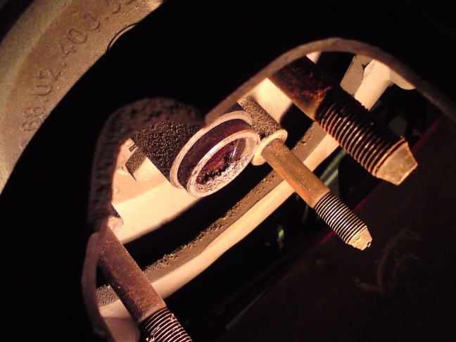

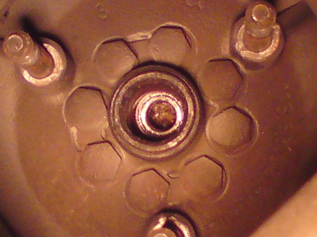

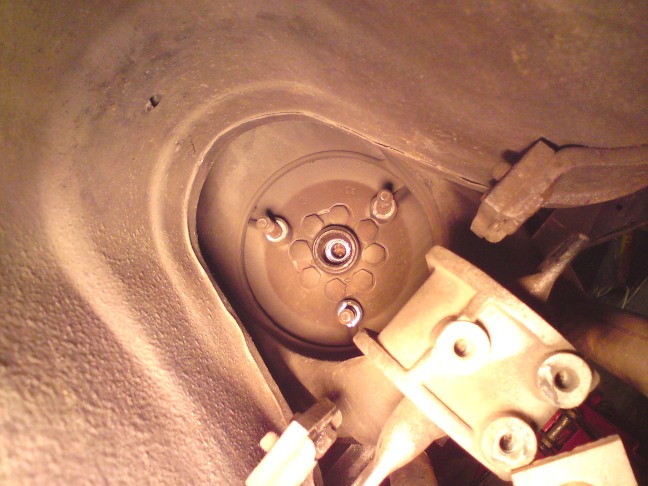

Mats you mean the pilot bearing? This how my flywheel looks. Funny thing is when I was removing the driveshaft, there was no pilot bearing on the driveshaft itself. Maybe that uncorroded bit sticking out from the flywheel is the remnants of the bearing? Anyway what also keeps me bothered is the length of the flywheel bolts. I assume that either flywhell side of the cvj flange would have to be as thick as the donut, which would suck in means of rotating weight OR make 3 sleeves that would press the flange against the flywheel.

There is a pressed in bushing in the flywheel, brass or bronze. Bolts need to be replaced, too long and too risky to cut new threads in the existing.

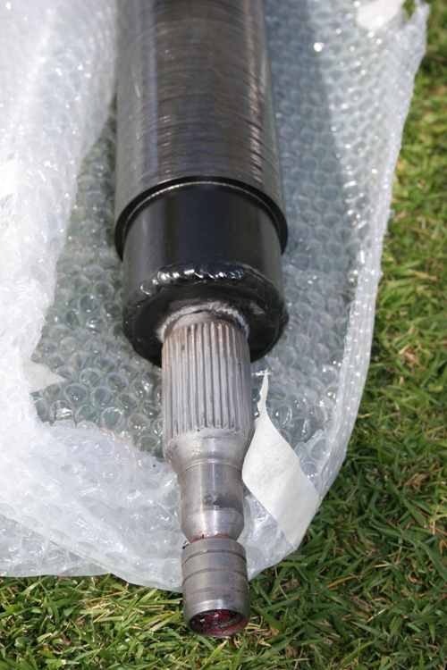

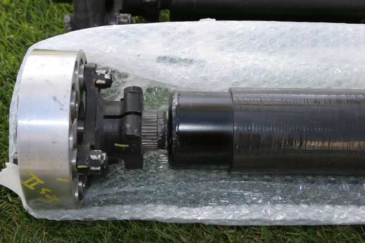

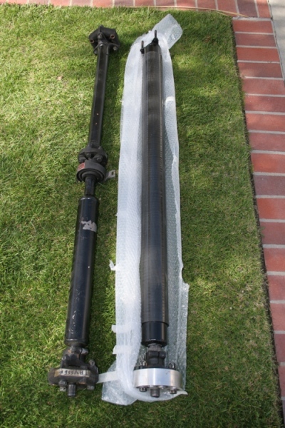

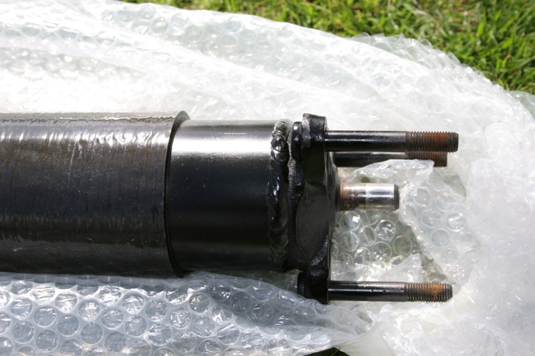

Here is what I have for the 3.7 24v race Milano. One-piece carbon fiber driveshaft with Scuderia Biscione front coupling. As you can see it uses Milano/GTV6 front splined section, but late Alfetta rear flange. I have Alfetta yoke and clutch cover with Alfetta slave cylinder setup on transaxle. The shift linkage is relocated from tunnel into cabin. The WRX STI guys run these kind of driveshafts also on their street cars.

Re: driveshaft conversion
Jes, just seen this. Absolutely awsome. The entire gearbox would have to be dropped to put this in or can you tilt the dedion enough.
Yes, I plan to slide the gearbox backwards a bit duing install and removal. Everything is currently out of the car, and that is usually the process I use anyway when putting dedion and transaxle back-in (or removing the combo).

A very nice job. Only sorry I cannot get one made in Oz.
Love the front coupling.

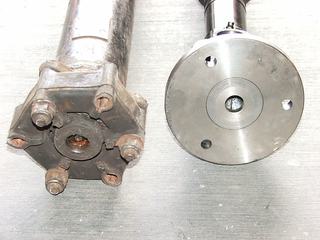

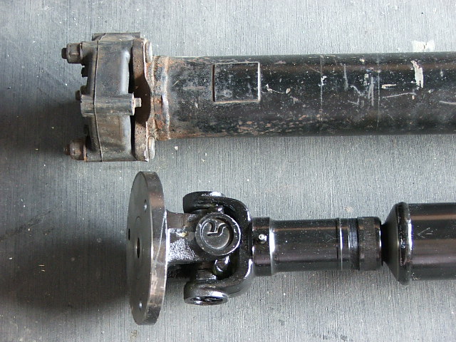

For the rear the Alfa coupling may still be a weak link. Perhaps a can over it like Kevin uses would help. However, (in any future redesign) I see no reason why you couldn't use a CV joint there as this would take care of the coupling issue and off course there is sufficient fore and aft slide in the joint to be able to fit the shaft without moving the gearbox at all.
Worse case scenario fit a universal joint with slip joint before it instead of the donut. That would also allow for rotation, location and length variation so you would not need to move the gearbox also. See photos.
Absolutely. It was made by ACPT - http://www.acpt.com Although I have not yet run it, it was based on a proven design from a race GTV6 (Al Mitchell) and according to Richard Jemison's specs. ACPT is local to me, so it was easy to visit them, bring various Alfa driveshaft pieces, discuss dimensions and design options, etc.
Although safety was my main motivation, it does offer a weight saving (of rotating mass). It is 1/3 lighter, or in absolute numbers, 7.5 lbs lighter (I think my bathroom scale showed).
