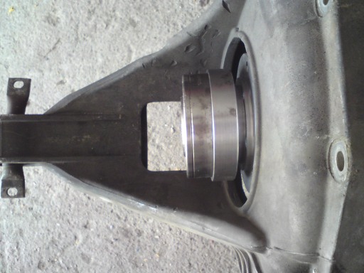

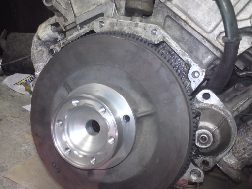

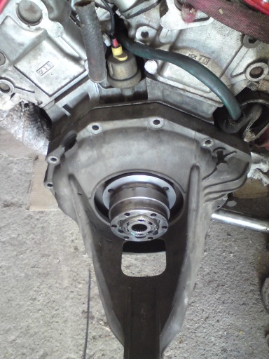

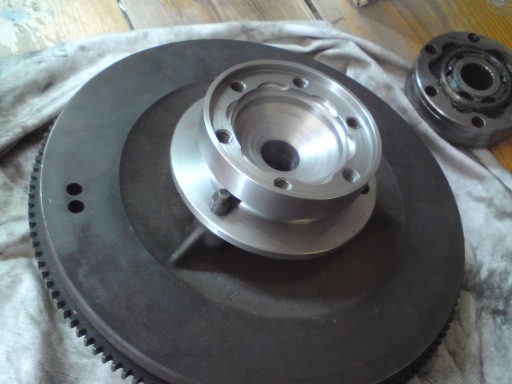

Finally picked up the front flange, everything fits great. I'm taking all the bits and pieces to the driveshaft shop today for final driveshaft assembly.
Cheers!
Cheers!
- DSC00021.JPG (62.79 KiB) Viewed 6898 times
- DSC00030.JPG (74.29 KiB) Viewed 6896 times
- DSC00022.JPG (90.42 KiB) Viewed 6895 times
- The flange and cjv are just over the bellhousing window, nice bonus for maintenance work
- DSC00023.JPG (68.68 KiB) Viewed 6894 times
