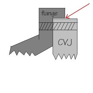

I also think I'll need to rework the rear flange, theres around 0,8mm slack between cvj and the flange. I dunno, give it a go and assemble the unit or have it reworked? Any opinion Mats, guys?

What do you mean by 0,8mm play? radially or axially? Any detailed pics would be good.

I hope this clears which kind of play I mean :wink: . I was thinking of boring it out a bit and putting some sort of thin sleeve... :roll:

Re: driveshaft conversion
You need to do something, needs to have a pilot and that surface is always the pilot on the CVJ.

Hey Pete,
Either I am the dumbest fella viewing this diagram or you cannot explain the problem clear enough because the flange to CV interface doesn't fit anything like you have illustrated so I find it difficult to comment because I do not understand the percieved problem.
From what I think I understand, there is no problem but..
Explain what you think might happen as a result of this so called 0.8mm shortfall, longfall ?
..and oh yeah, clean up that friggin garage it's a pigsty.. :D :D
it's a section... 8)
no it's baloney. :roll:
Well, if you knew that how can you say "the flange to CV interface doesn't fit anything like you have illustrated"?
The CV joints in propshafts fit exactly like that and it needs a pilot or it will be off center and vibrate like nothing you have ever experienced. The pilot surface on disc-style CVJs are on the OD of the disc, if there is 0.5mm of play it needs to be fixed somehow. Normally there is actually an interference fit present but that can be a bit too annoying if you want to be able to get it off the car without explosives... :)
There are 4 fixes for this;
1 find a cv joint that has the right outside diameter for the flange.
2 weld and remachine the flange to fit the current cv joint
3 sleeve and remachine the flange to fit as above
4 make a new flange to fit the existing cv joint
The flange should be .0005-.001inch bigger diameter than the cv joint. better would be if the flange had a little taper (half a degree) so that the cv joint is supported radially (like Mats said) when it hits bottom on bolting up.
hth
The fit actually depends on which manufacturer you talk to, at Volvo they use interference fit and at Saab (GM) they use a slight play. When I say slight play I'm talking a lot less then 0.5mm but I can't remember the exact numbers right now.
For the interested, I have one Volvo flange and one GM/Saab spec. flange. :)

Thanks for the tips, (and even to those who could not comprehend my super-duper elaborate schematic :P )
I'm taking the flange to the shop tommorow, and see what they come up with. And then maybe next week, the grand finale...
