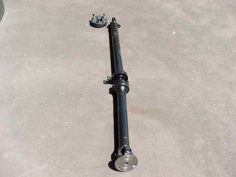

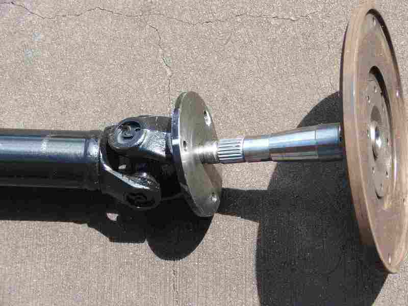

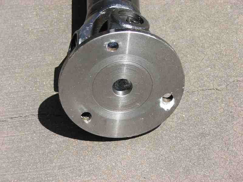

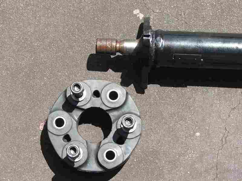

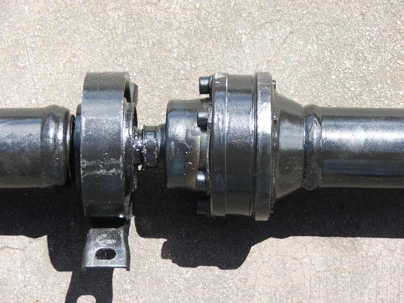

You blokes are pulling tonsils out through the arsehole. This is how you do it.
The BMW coupling has 14mm crucher tubes that need a 1mm wall thickness bushing to convert the 12mm Alfa bolts to take up the oversized holes. (Not shown in photo)
No noise. No vibration. No shredded donuts. No hassle.Cheaper than refurbishing and original Alfa shaft. Easy to fit and remove.No need to drop transaxle.
