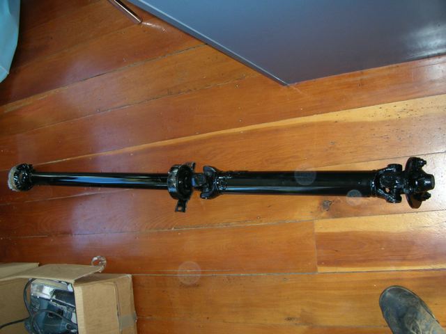

quite some time ago i posted some pics of a driveshaft i acquired that used a cv at the front and uj's in the middle and rear. after having it stashed in my garage for the last 5 years i have finally got round to working out its fitment and installation.

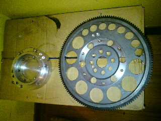

similar to mats i made a new flywheel that fitted to the cv adapter i already had pics of the flywheel are elsewhere on this site but ill post one here too.
flywheel and adapter
driveshaft
driveshaft
having read most of of this thread some time ago i was a bit worried about what the results might be.
the only thing i had on my side is that this shaft had already been in a race car that was quite successful until it was written off.
in the last few weeks i have finished some engine related work and have now got everything up and running.
so far i have not been on the track or near a dyno so cant comment just yet on how it runs under power but what i have seen/felt so far has been promising. i have had no drumming/pinging that MD has described and the whole assemly has felt very smooth and balanced. im hoping that this will stay the case when under power since i took great care to get the whole bottom end balanced with the new flywheel and hub before assembly.
of course this is all very easy when the engine and car are not under any load but i also have a very firm nolathane set of front gearbox mounts and a nolathane bellhousing mount aswell, so im hoping that these mounts will help restrict the movement of the engine and trans. once i have had a chance to test i may look into an engine mount suggested by md at the beginning of this thread but will leave that for now.

so, after a very long time, everything came together and i went racing on the weekend.
everything went extremely well.
my new driveshaft worked a treat and was both quite and smooth.
the only noise came if the engine revs dropped below about 900 rpm.
apart from that it was perfect. so much smoother than the original driveshaft i had in the car before this one.
when i get more time ill post a bit more in the race car section with a bit of an update on the car.
just thought id post a positive update on the new driveshaft.
