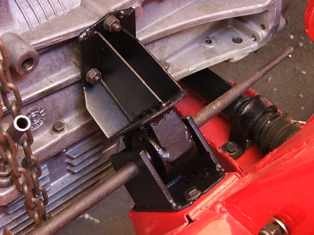

Here's my modified front engine mounts. Both left and right are the same.The rubber bush is of a much higher density than the original Alfa compound. It is actually a Range Rover suspension component.
The point is this. The set up restricts engine rotation and does not require an engine restraining bar.This of course minimises changes in angularity under torque. Coupled with a similar modification to solid rubber mount for the rear engine mount, the net movement of the engine in either fore and aft mode or rotational mode is minimised.
This is in the race car application.
Strangely enough, the amount of harshness is a lot less than you would expect and it is really quite acceptable.
So getting to Mats point, when I set up the prop shaft for straight operation in the static mode, it will approximate the situation under operational mode and when coupled with any gyroscopic effects
when rotating, it does maintain correct angularity I believe.

MD, remember your car starts in a straight position unlike the gtv6 so you cant do it in the 6. If I recut my engine mounts and aligned straight then it would work.

I didn't know that there was any specific inlcine in the V6 engine not that it matters as these are hand made mounts and you should be able to fabricate any angle you need.
Just had another simple realiasation.Whenever I have had a prop shaft that was balanced with the car stationary but revving the engine through the range, it never produced a vibration. Nor did it produce a vibration under load when the car was in motion. I am assuming zero anlge changes as engine revs change due to almost no load when it is stationary.
Conversely, a car with an out of balance prop shaft at staionary position only got worse under load and seriuosly whacked around 3400 rpm.
That suggest to me that the misalignment thing under torque is possibly not as relevant as first it appears and lining the prop shaft up in the straight position should be ok in the absence of evidence to the contrary.
Of course this is just an explanation about a balancing issue as in those cases, i never checked the angularities so I cannot say for certain..
