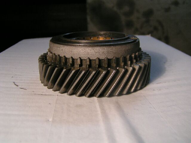

Some weeks ago I was asking about syncros, how to fabricate them. Then Barry advised me to make them plasma sprayed instead of fabricating.
THANKS BARRY!
I' ve found a repair shop who was able to make the syncros plasma sprayed. The mystic material that was sprayed on the syncro was Mo (Molybdenum) Hope this is the right english word.
And this is how it looks like:
The complete 2nd gear unit with the new syncro.

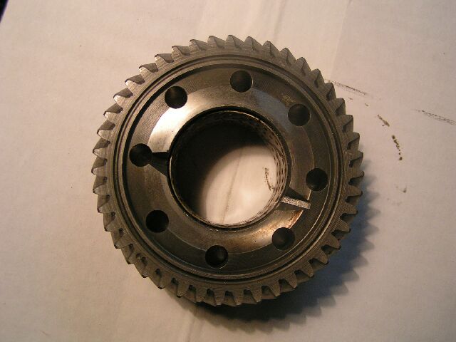

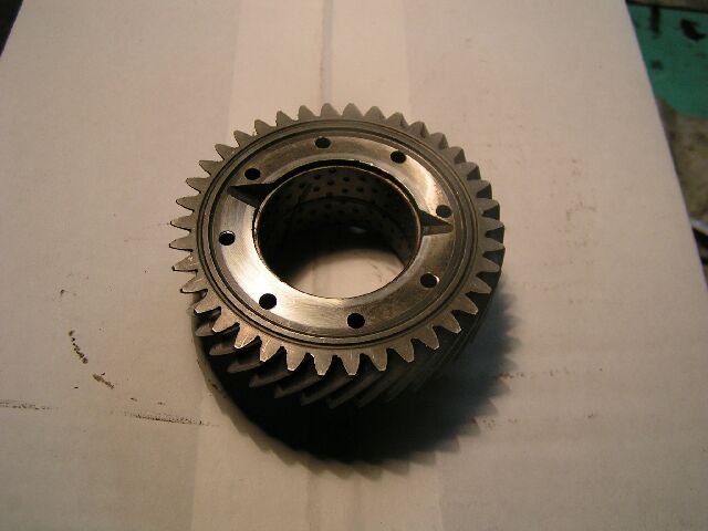

All the used parts were changed to better ones.
Here's a demonstration of a before/after gear.
Check out the teeth.
After
After
Before
Before
'The GTV': '83 GTV6; (summer)
ingegnere
Posts: 63
Joined: Tue Jan 04, 2005 5:02 am
Location: Hungary
Post by ingegnere »
And also the 2nd and 3rd gear were lightened slightly.
Yes, only these two, and only that "much", because the gearbox should be able to carry an extra 100Nm of torque in a long reliable distance.
I think in this case the less is more. :roll:
CNC machined,8 pieces of 8 mm holes, 2 hours of labuor.
Same, only these holes are 5mm diam.

Post by ingegnere »
They're from the old box.
I took them to the machine shop where the surface was cleaned from the worn material and re-plasmasprayed with molybden.
We didn't try the box yet, but we expect it will behave as new. :)
