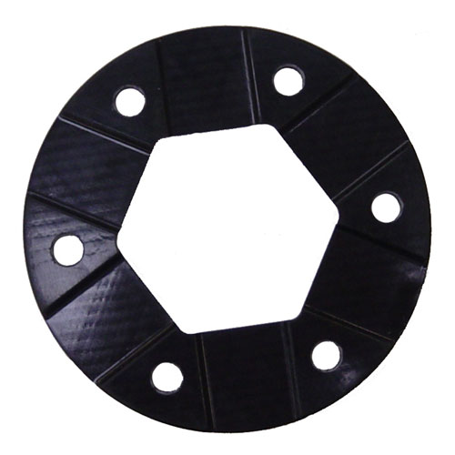

These might be interesting...
http://www.torqline.com/product_detail_9.php
--Carter
[do we still need rubber somewhere?]
--Carter
- torqdisc.jpg (25.95 KiB) Viewed 7973 times

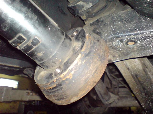

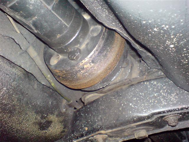

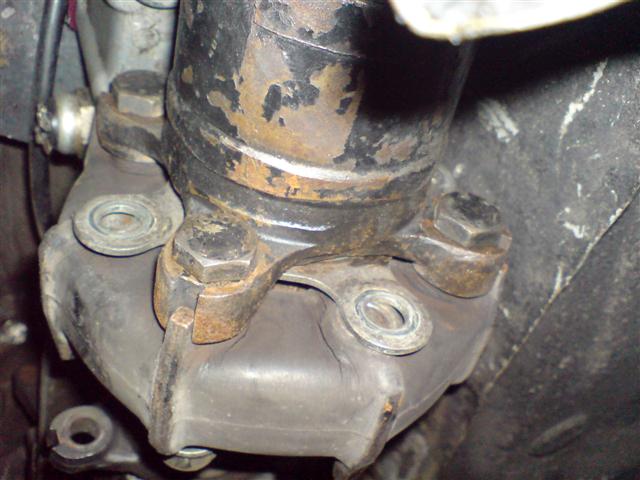

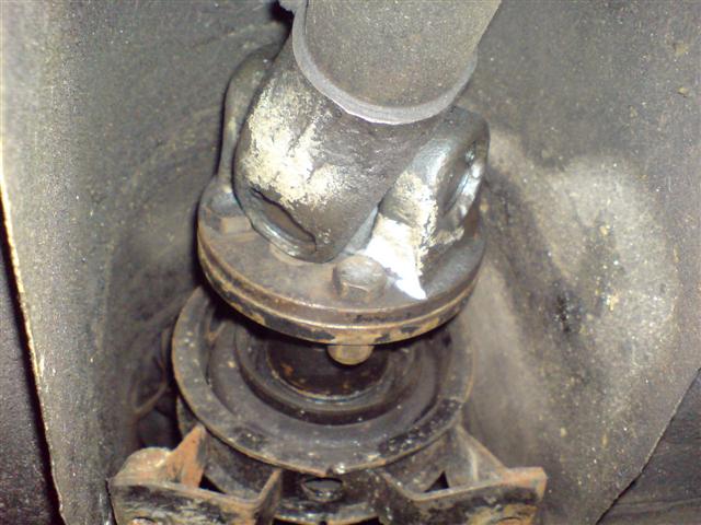

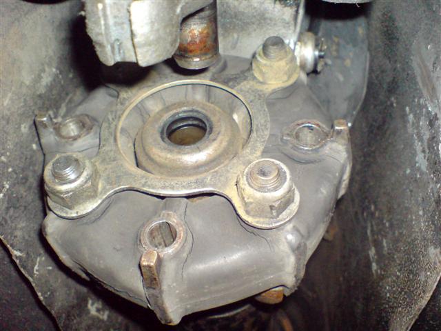

a bit off topic but look at this pics i snapped from friends SEI 2.5 TD, reinforcement plates on front guibo ... and this is F.M. gearbox , no crazy rpms
sei prop is almost half the lenght and double the weight compared to 75 one
- DSC00060 (Small).JPG (56.86 KiB) Viewed 7707 times
- DSC00058 (Small).JPG (57.48 KiB) Viewed 7711 times
- DSC00057 (Small).JPG (51.8 KiB) Viewed 7709 times
- DSC00056 (Small).JPG (54.47 KiB) Viewed 7707 times
- DSC00052 (Small).JPG (67.69 KiB) Viewed 7712 times
