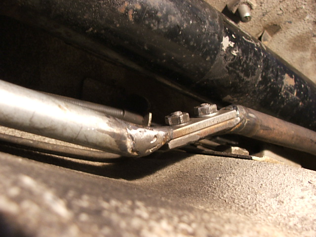

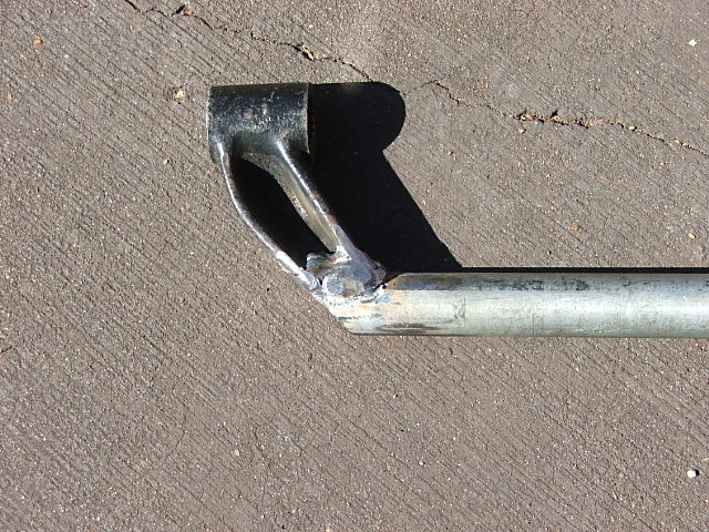

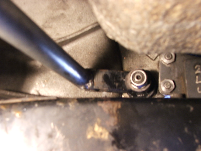

Recently the wife's Sportiva decided to mangle yet another doughnut so the driveshaft had to come out. At this time I decided to improve the shifter on it while it was out anyway.
The photos in various parts show this:-
1 An 30mm extension to the selector at the bottom
2 A relocation of the pivot tube to the transverse bar
3 A relocation of the captive connection from the transverse bar to the base of the selector.
4 The forming of a new flat section on the transverse bar to maintain clearance around the crossmember due to the selector extension.
5 A new coupling location for maintenance and dissassembly purposes.
6 A new connection point on the crank .
The purpose of these changes is to reduce the radius length ot the crank and increase the radius of the selector. The two together produce a shift that is shorter with a smaller gate.
The beauty of this arrangement is that it maintains the location of the components within the tunnel areas as before without the need to do the extensive modification of my "topside" modification.
This modification does not produce the same "stick-in-the-box" feel of the "topside" conversion but simply retains the typical transaxle shift feel with about a 35 % shorter movement overall.
NB
1 You will need to remove as much as possible from the inside edges of the plastic retainer that retains the spring under the ball as the added length of the selector will foul it and will inhibit full engagement of some gears notably 2nd.
2 Take care when welding the pivot tube not to cause heat distortion by short weld & cool cycles.
