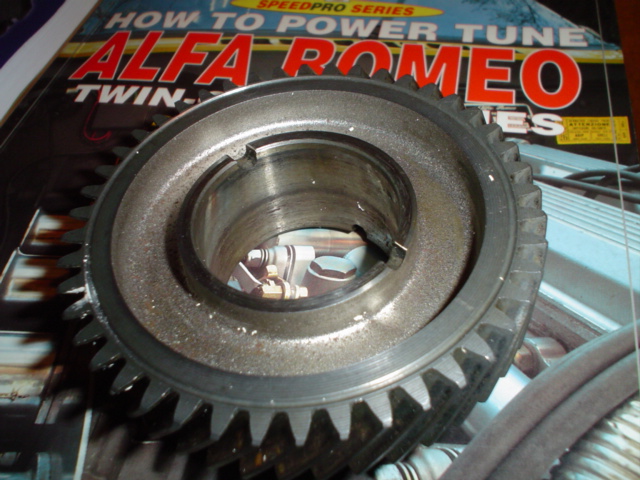

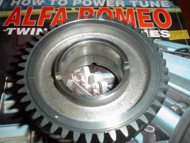

That lightweight 2nd gear....Barry
:!: I finaly found my sample 2nd gear that we used for the proverbial quick shift to 2nd...
I removed the material by spark errotion method..Lightened the assy by about 30% only--And I removed a lot of material.
The strength and integrity of the gear was paramount in the amount of material removed.It had to be super reliable and this was done on some computor annalysis at Denel (Militery aircraft manufacturer) by a friend of mine.Any more material removal was deemed unreliable...
Thought I would make the pix background more interesting as well......

nice baz,
how much do you expect this work to cost? for example, if the box was out and the gears stripped for synchros, would this really be "prohibitively expensive" or merely an incremental expense?
for street or even track work, the stock gears are bigger (heavier) than you need right?
why this method of machining? would not high speed machining further work harden the steel?
edit: ah, never mind... i actually read your post !
CAD huh? so i guess this machine controlled the spark machine with the gear the electrolyte?
damn nice baz, i didn't know tinkering with the alfas got this advanced..
Spark erosion, brilliant. :)
Just for your own box? Me wants! :D

Joey,The method of lightening the gears was accuracy and My mate did them at no cost for me.Try cutting these things on a conventional lathe-sparks and grinding with very little progress.I must also admit that we tried on a donkey lathe with probably not too great cutting tools-Im sure it can be done correctly.
John,It makes sense as to what your saying about doing all 6 gears-never looked at it from this perspective before-When you say Andy is drilling them,explain please-Is he drilling right through or just plunging into the gear?
As for spark eroding,it was available at the time so I used the method.No ,we never shotpeened them as the finnish was good and the core of the gear is actually quite soft-These were obvously only case hardened .A good friend of mine at Sanvik reckons this is the only process that thoughens the gear as well as makes them hard wearing.Makes sense,huh?
Mats,thanks,you cannot believe how I thought about the spelling of erosion......Crazy.......
