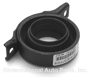

As you probably know, the GTV6 shaft is two piece with three rubber flex joints. The main support bearing is located about mid-way and held to the tunnel by two nuts to two studs. It is deep to the exhaust and heat shield. Pic of main bearing support below. Big round part is closer to the ground. Of course, you need the bearing, clips , and dirt slingers... all found at International Auto Parts Alfa.
