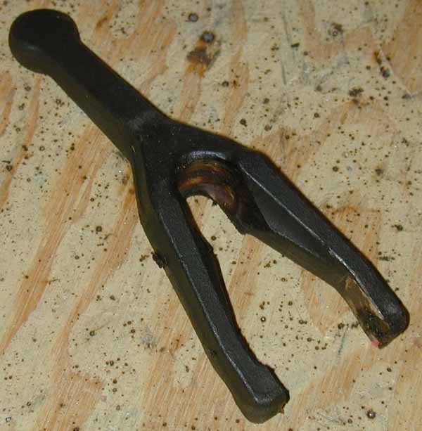

I went under the car today and the slave cylinder was leaking. I gave the clutch fork a gentle tug and it came out, along with the rod that pushes on the fork.
My guess is that the slave cylinder blew a gasket, but that doesn't seem to explain the sudden loss of pressure at the start of the problem. I'm now thinking that both the slave cylinder is leaking and the ball spindle (is this the right name? It's the ball inside the transmission that the fork rests on) is broken.
Are there any tricks to removing the slave cylinder? I've gotten the circlip off, but can't get the leverage to pry it out (I can get it to turn though).
Is there any easy way to check whether the ball spindle is broken or not, short of dropping the transaxle?

I have heard that the fork and pivot on the twin plate clutch setup are prone to wear. Check the fork for excessive wear at the point that it contacts the pivot. This will give you some indication if it and the pivot are stuffed. If they are not, now is a good time to lube them.

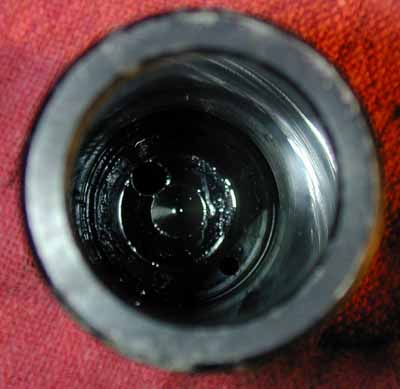

Okay, well I got under the car today and felt around inside the transmission. I could feel a bolt and nut (I think) right inside the hole, but it didn't feel like the pivot at all. Other than that, I could feel something that could turn (seems like what the fork would push against).
From this, it appears that the ball spindle (pivot) is broken and should be where that little protusion is. If this is the case, I guess I will need to fix this if that description sounds accurate.
I'll finish pulling the slave cylinder tonight and see what kind of condition it's in.
If the pivot did break, the slave cylinder would have had to extend a lot further than normal. Would this cause it to leak? Or is it most likely trashed?

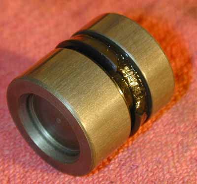

Well, I got the slave cylinder out. It seems like the cylinder itself is in good condition. The piston also seems perfect, except for the rubber seal around its waist.
Can I buy just that o-ring? Or is this a full cylinder replacement?

Thats what goes on the slave cylinders. When I had to get a new on I looked for a rebuild kit but could not find one. I ordered the cylinder from San diego Alfa (no affiliation). The delivery is very fast and its the cheapest one out there.
