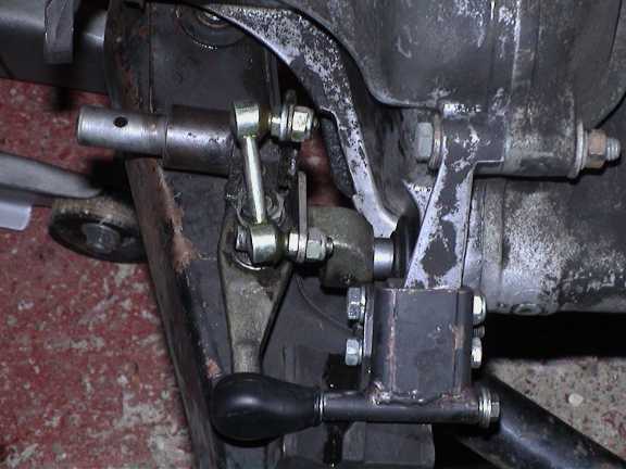

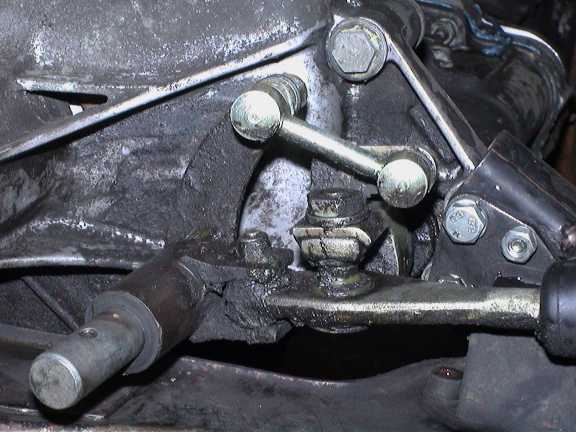

Verde tranny going in 85GTV6. I have the iso links and shift rod. Anybody have any tips?
Can someone post some pics of their shift linkage?

Hope this helps.
Thanks Murray, it all makes sense now.....parts came to me in a bag
Do you know if the tranny mount at the linkage is different than a GTV6?
x-rad to the best of my knowledge all the isostatic setups are the same.The one on my 89 75TS is the same as the 86 GTV6.
Murry: I was more concerned about the tranny mount. My original trans is a non-iso 85. The one going in is a verde. As far as I know, I have all the parts including a GTV6 iso-shift rod...just wondering if they will fit into a 1985 GTV6....

x-rad it looks like you have all yhe necessary parts.Have you read this section taken from the "digest clippings" on the main site ?
http://alfagtv6.com/cl_gear.htm#GTV6%2 ... e%20Milano
Towards the bottom there is some info about making the conversion.You do realize that the process involves the use of a large hammer :shock: to increase the clearance to the floorpan so talk to her nicely before you start wacking :lol:
As far as the tranny mount goes you have to add the plate (which I've highlighted in you photo ) and you're all set.

The floor is different, I think it will be difficult to fit the iso linkage on your car. The best solution would be to switch the shifter axle in the box and use the old linkage.
That's what I have done on my racecar.
Thanks Murray, link had some tips...
I would rather cut and weld a new floor patch than change the shift rod. The tranny was recently rebuilt so I really don't want to take it apart.
Hopefully, I have the correct shift rod. I was told it was from an 86 GTV6 and not a milano.
1) fix floor for linkage
2) lengthen front shift rod a little?
