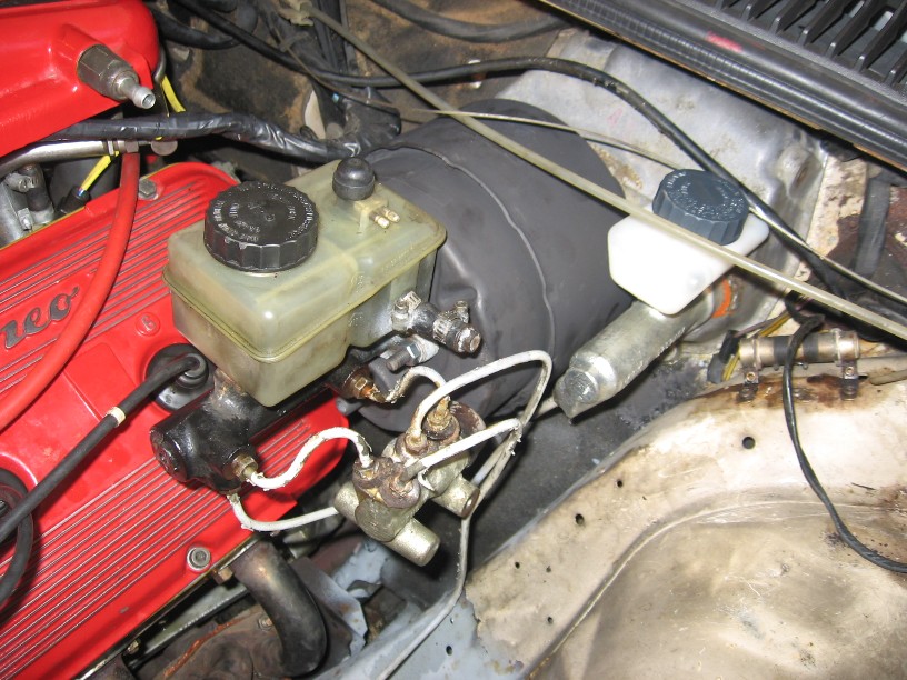

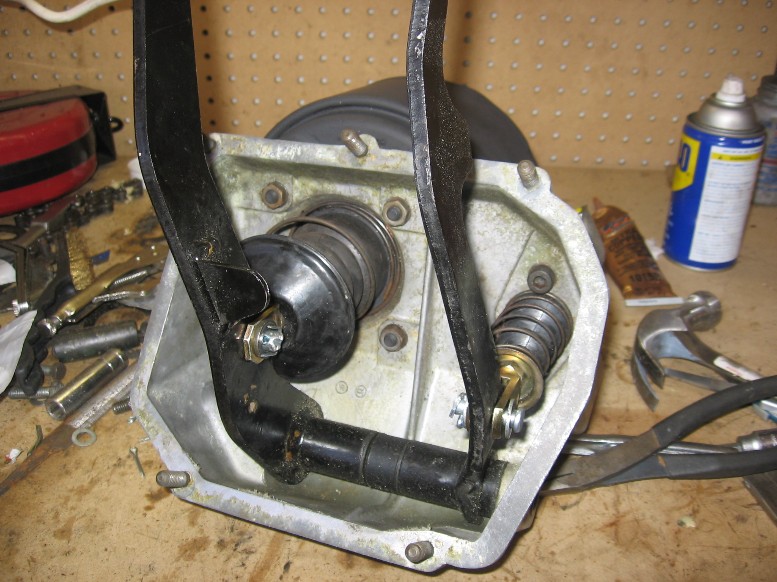

Anyway, I have to take back my design peeve I stated above to start this thread. Frustrated by the difficulty removing the two rusted allen head screws holding the brake master cylinder in place, I tried something different.
For those who already know, skip the rest.
There are five easy to reach lipped nuts holding the pedal box in place. Two on top, three on bottom.
Undo the three brake lines to the brake master, remove the valve support, undo the line to the clutch master, then undo the five nuts under the dash.
The whole unit removes easily, up and out. Then its easy to replace what you need to. Much easier to replace springs and pins as well. Only drawback is now I have to bleed the brakes, too!
Back togethger with new head, No leak this time.
