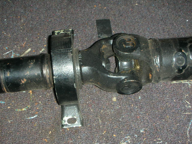

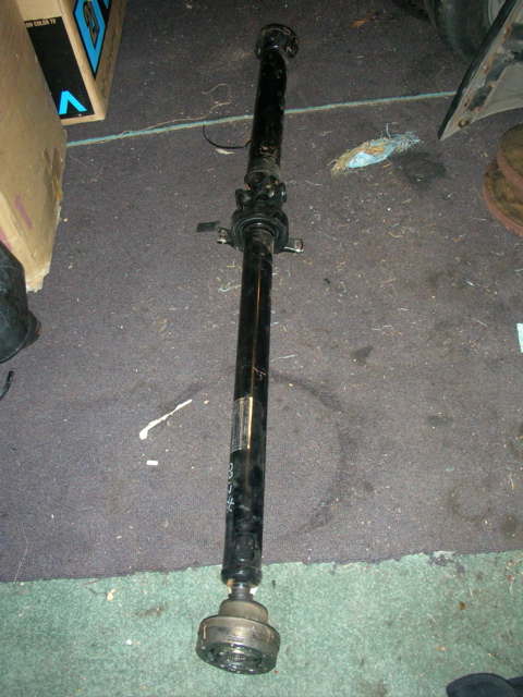

as requested some info and pics on my driveshaft converted to uni's.
the rear section measures 510mm. the front measure 855 extended and 820mm compressed.

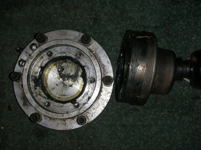

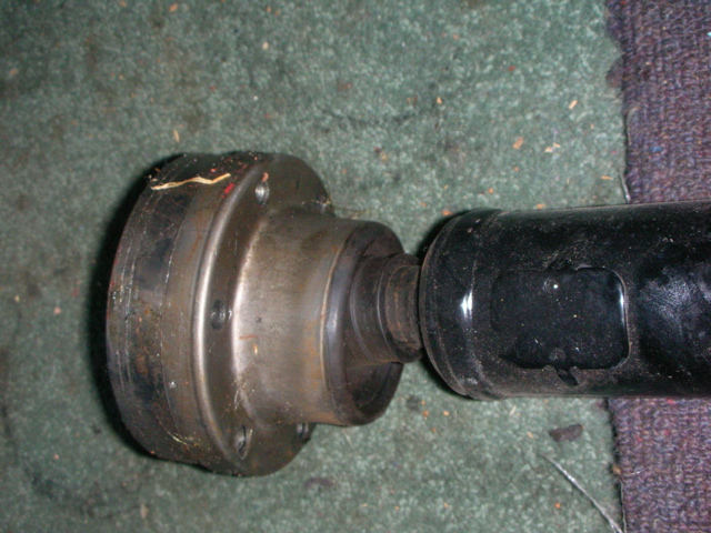

the aluminium disc is the carrier that bolts to the flywheel and the CV joint at the front.
it doesn't seem too heavy! i will weigh it and compare with the standard set up and let you know the results.
any questions, fire them through and i will try and answer them!
anyone out there have any input to this set up?
i didn't design it, it came with a wrecked race car i bought!! im told it was developed with the help of someone involved with the preparation of the south african racing V6's.
does it look like a good solution to the rubber donut issue??

Thanks mate. That's excellent.
The real value of this info though is to have it checked for balance and fit it to a road car and see if all the claims about vibration are acceptable or not.
If it works, goodbye doughnuts forever. It's cheaper to make a whole new shaft like this than to replace all the doughnuts and rebalance.
What are your plans for the shaft?
X-rad. There is only one slip joint required. It could be at either end but probably at the front it would be most useful.

MD: how is it possible that only one slip joint required when both the front and rear of shaft move in relation to the center bearing?

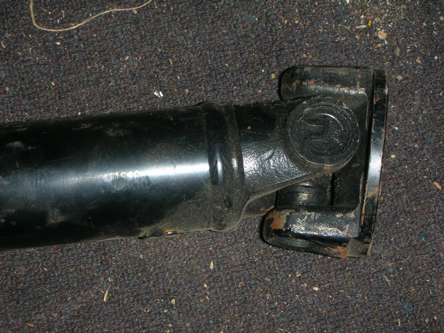

Got a pic of the front of the tranny?
The universal joint looks like something off an axle?

The front joint is obviously a CV-joint wich can take up quite a lot of plunge (and it has the J-style boot I was talking about earlier), the rear movement is probably taken up in the center bearing support. The movement is probable next to nothing though and the std propshaft doesn't have any sliders or anything so I see no problems. I guess the racecar had uprated mounts in both engine and gearbox?
What's the PCD on that front joint? Looks massive!
Tube diameter would be very interesting as well.

Of the two, the tranny is better tied down and is likely to move less because the engine will pivot and rotate, particularly if you have soft engine mounts and a crappy rear engine mount. So I would expect greater angularity to appear behind the engine.
The benefit of the slip joint is to make fitment much simpler and take care of minor differences of location between the engine and box. If you have a fixed length shaft, you have to adjust the position of the box and/or the engine to be sure the shaft is correctly positioned and the doughnuts are not "stretching" as they rotate.

An alternative to using a CV up front is to use another Uni and make a spigot fitment into the flywheel via a flange. Saves on rotating mass.

im trying to find the fitting for the flywheel end, i didn't get the G box but know the guy who did so im hoping to be able to get the other half of the rear joint!!

The rear coupling flange is more likely than not simply a circular plate with a centre provision to couple over and centre on the triangular gearbox input flange. It's critical that it is definitely centred.
It will have holes to mate with the Uni. and three holes for the flage.
