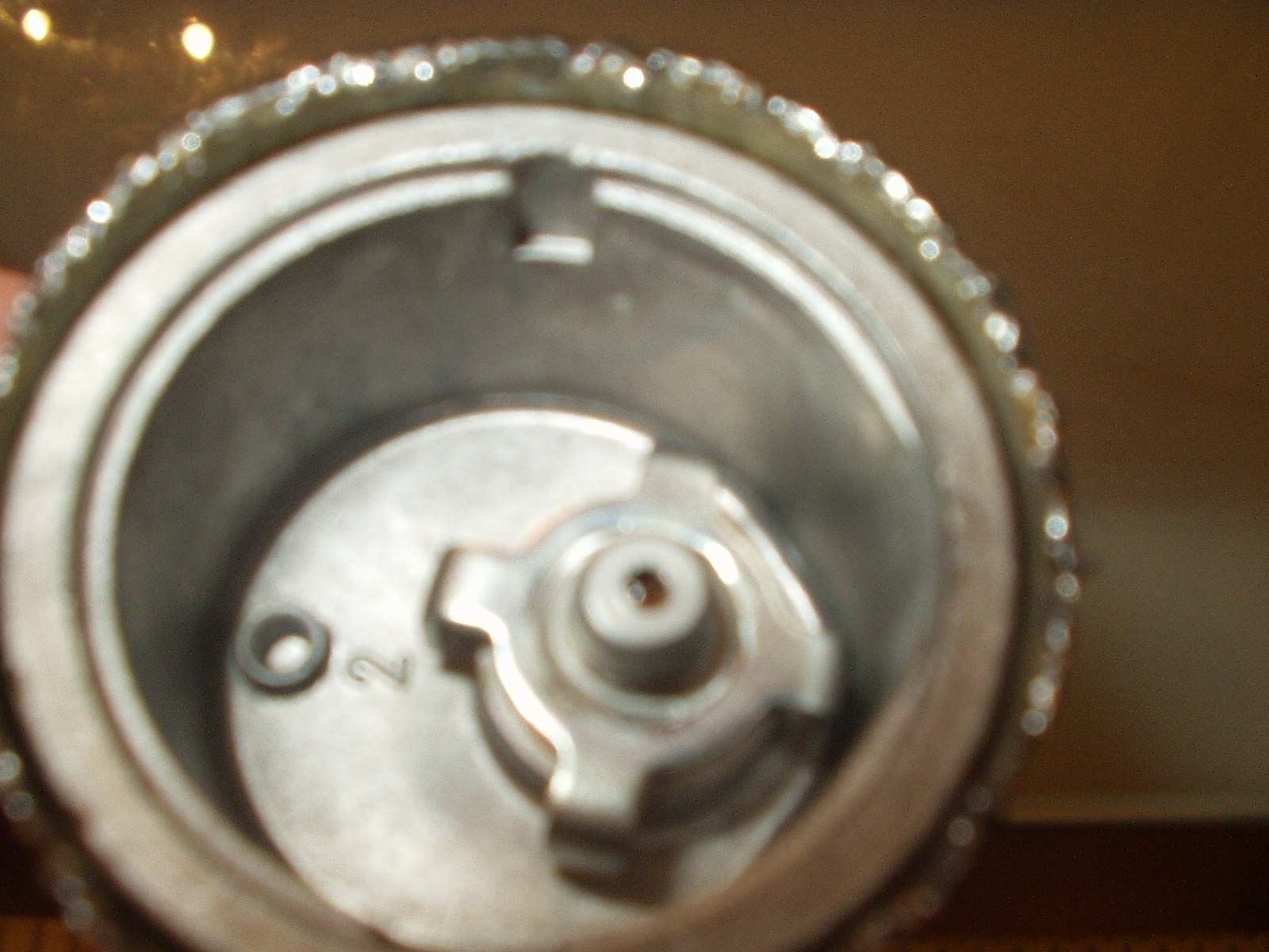

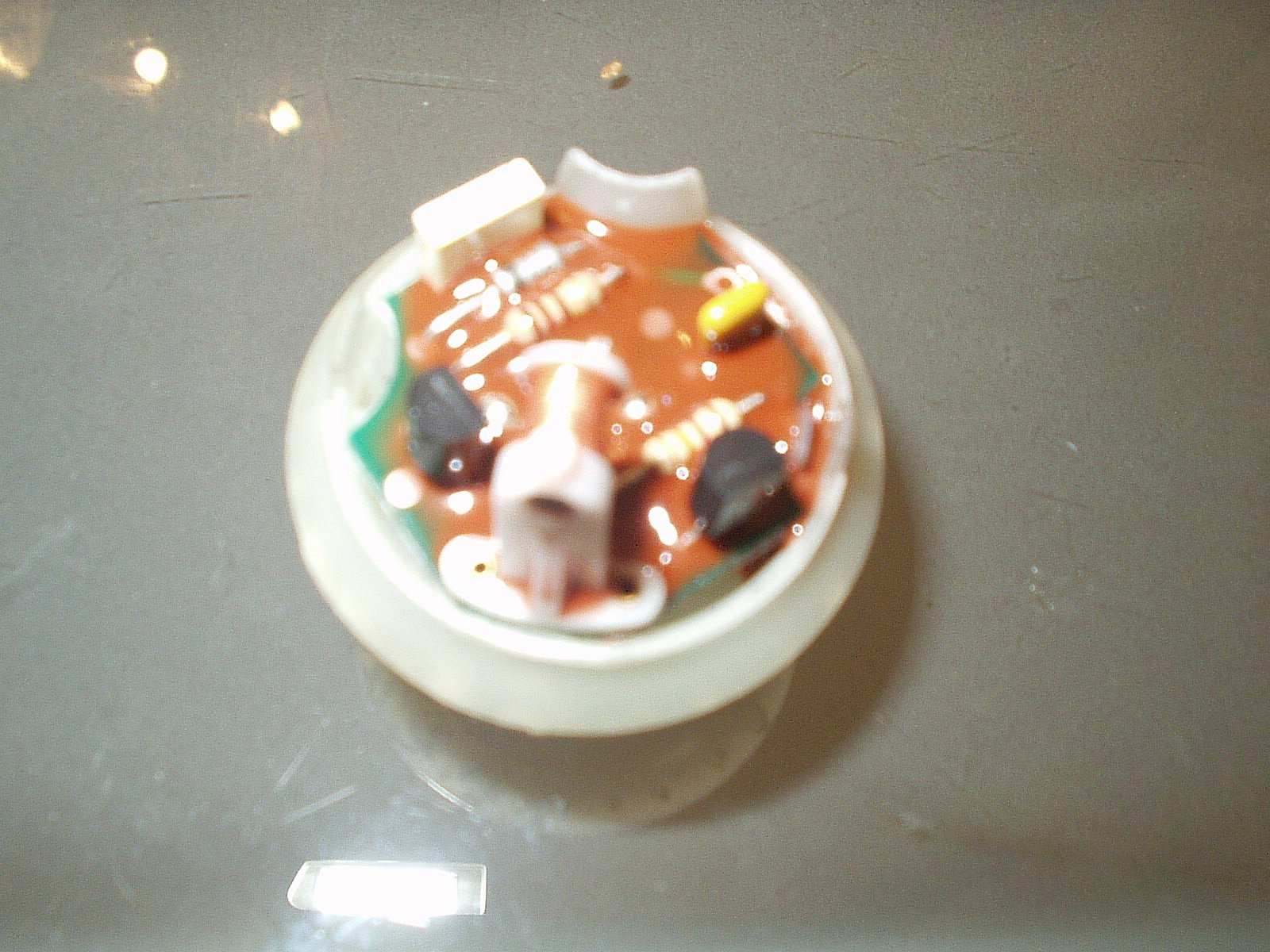

just prise the sealing ring open all the way round, and the sender just pulls out, they were outrageously expensive considering they are worth about $5-6 dollars in parts. trouble is some of the pcb components are not marked, so its an educated guess as to their ratings, eg the capacitor.

this is the unit opened up, poor pictures but you can see what is what. the PCB and the rotor which generates the volatge pulse through the coil.
9/10 times problems stem from the solder joints drying out, from vibration.
It is not necessarily the case that the sender is faulty. These guys a pretty reliable, the speedo head itself , less so.
A simple test.
Borrow a known good speedo head and substitute it for yours to trial under the same conditions. If there are no faults displayed, you have your answer.
You could of course do the reverse and substitute a known good sender...
