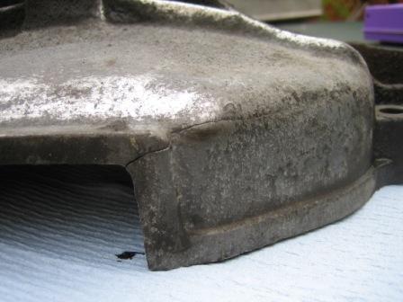

Removed today the transaxle complete. While cleaning 24 years worth of crap of it I found some damage to the clucth case. What do you think, should I replace the case or forget about it?
Ta, Tony[/url]

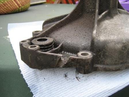

Second bit of damage, caused by the brake line rubing I think.

Tony,
These things abound like wild mushrooms.. :D Just replace it with a good used one. Welding it up would cost you more and more than likely distort it..
Yeah, agree w/ MD
even though the crack is in a lower stress area, would definately replace it...
Problem is many people want to sell you the clutch, too and that is more money...in that case, welding might be the better option
