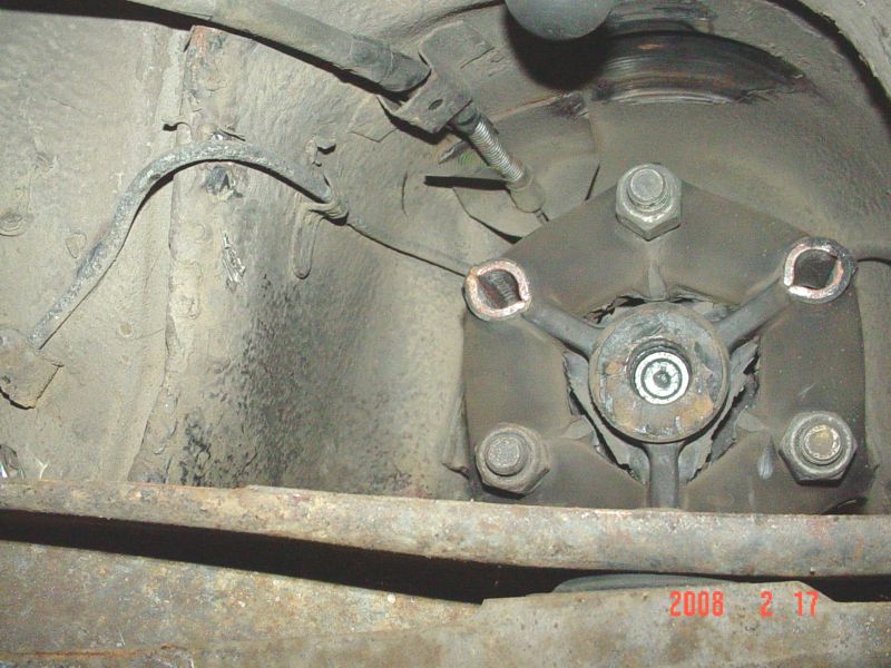

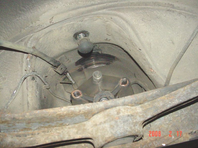

well i finally found where the thumping comes from on hard acceleration ...seems the rear joint is contacting the body...mind you its only on hard acceleration ONLY.....
when i first worked on the car i installed the new rubber joints for the previous owner....ive read alot of posts about different sized joints and am wondering if its this rear joint that is a different size from stock....what i do know is that the spacer blocks on the transaxle mount are thinner than milano ones if that helps any ...
the gtv6 in question is an 83 "leftover" ballocco if it matters
the question is...what do i do about it?..and how do i correct it?...there were ZERO vibrations or anything abnormal ..smooth as silk EXCEPT on HARD launches...at first i thought it was violent wheel hop
heres a few quick shots a grabbed today

i didnt do a full inspect of them but they looked to be in good shape..ill get a good look at em tomaro and make sure 1 hasnt failed

A close look at the transmission tunnel clearly shows where the rear brake lines are located with respect to the drive shaft. On this occasion it's a simple case of bump stop adjustment. End of story.
The other story is not so cute. This is when the donut lets go and thrashes around in the tunnel tearing everything up in sight INCLUDING your rear brake line. Suddenly you are in deep doodoo.

Adjust the snubber, problem solved.

and double check the gearbox mounts... get a tire-iron and try to lift the gearbox from the front beam which holds the de-dion triangle.
I agree the gearbox mounts are important, and often overlooked.
