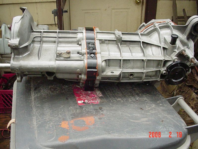

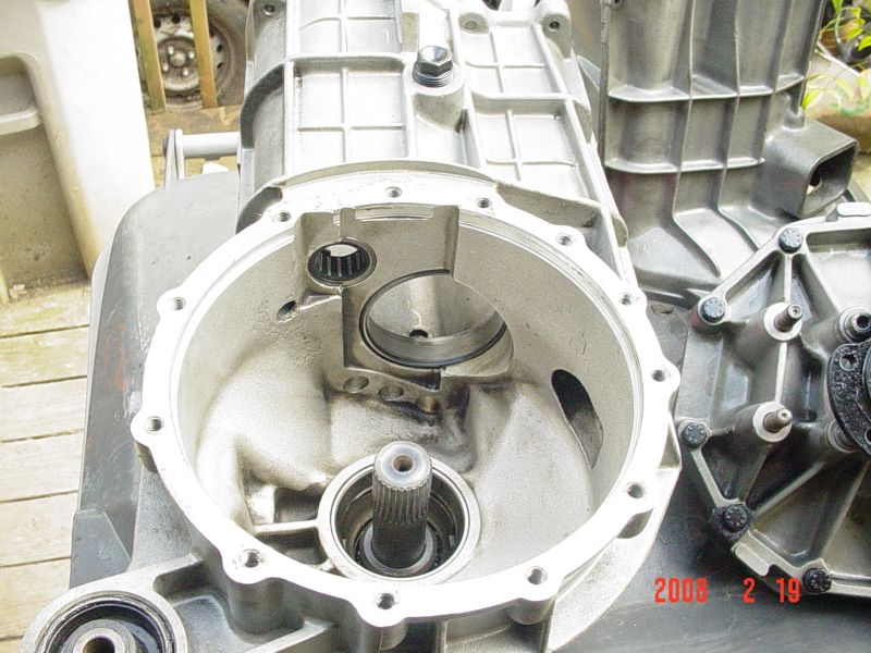

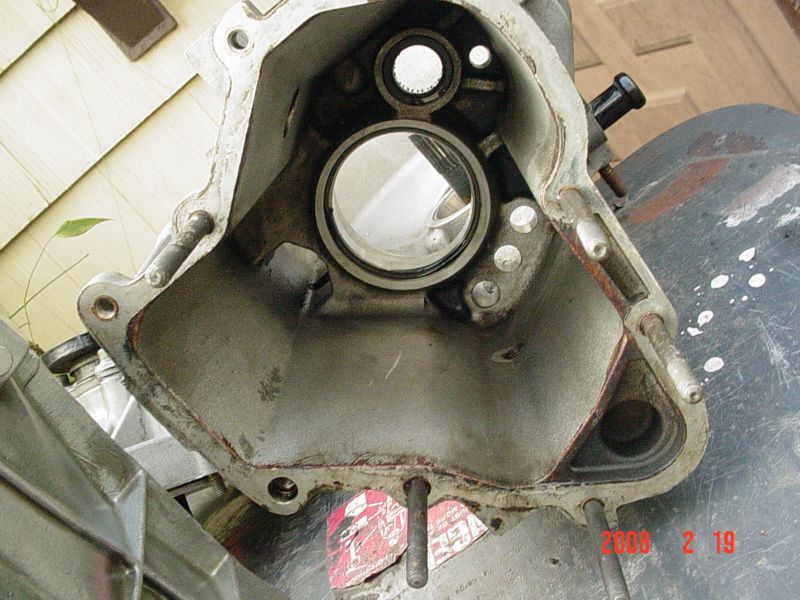

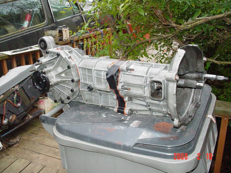

she lets me clean and paint in the house...mind you this TS box was pretty clean(on the outside) when i got it from JJ..other than a few greasy pawprints all over it :p
cleaned, clear coated(except the sealing surfaces wich were cleaned just befor assembly)..center section painted black bolts painted black too...brake cleaned out the guts so the new synthetic fluid will be on clean internals
ignore the sealant hanging out of the seals..i razor bladed it off after it dried
cant wait to get this into the gtv6...waiting on JJ to send me a speed sender so i can put this baby in
