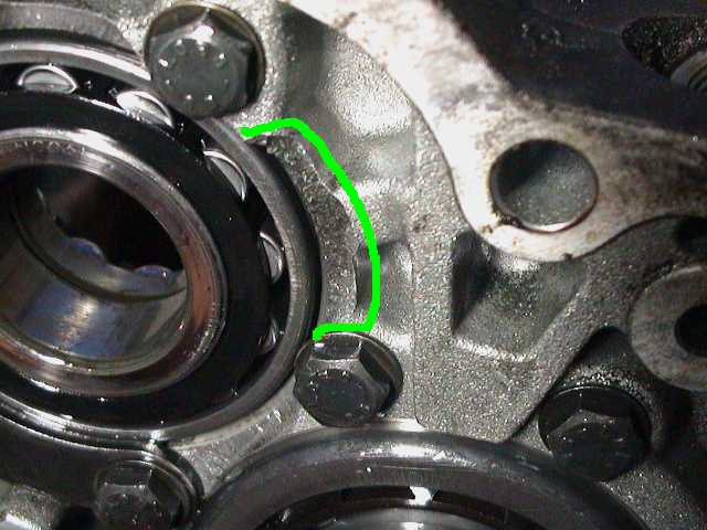

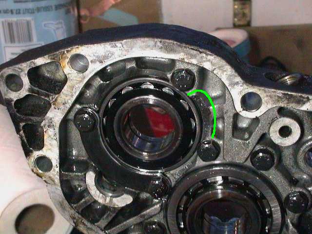

Z about 4 years ago I rebuilt my transaxle and at the time I discovered a large chunk of the intermediate plate was cracked and came off in my fingers (see highlighted area) .What I did was fabricate a half-moon brace out of steel similar to the one the factory used which is seen at 7 o'clock in image 1.I didn't take a photo of my fix at the time.My thinking was that this would help stabilize the bearing in this area where the casting was obviously weak.It's been about 60k kms. and many track miles since and so far so good.

Hang on one minute here, Roller bearings?? :shock:
All the Gearboxes I have come across have angular contact ball bearings with loose inner sleeves, why the h-ll are there tapered roller bearings in your gearbox? 8)
As a theoretical side note: A brace might look like the correct solution but may be counter productive as a very stiff section will take up a lot of the force from the bearing and focus it in a single point like one of the screws. I'm not saying it does in this instance but making it stiffer isn't always a way to make it stronger.
mjr
Posts: 441
Location: G Britain
Post by mjr »
that area looks to be subject to stress from both the bearing, but also the two bolts. Im not surised that area is weak, stress from 3 different directions compounded in a very small area, over time and mileage = premature embrittlement. There is very little material around the lower bolt in the first place. .Im surprised how much porosity there is in this casting though, that is piss poor, even for the early eighties. Are these boxes thoriated at all? anyone got a giger counter? :D
Good question Mats - one to which I don't have an answer :shock:
This is a 1986 Isostatic link transaxle which has been in my car since I bought it 6 or so years ago.Should I consider myself privledged or was it a production run change - not that Alfa would do that eh! :twisted:
