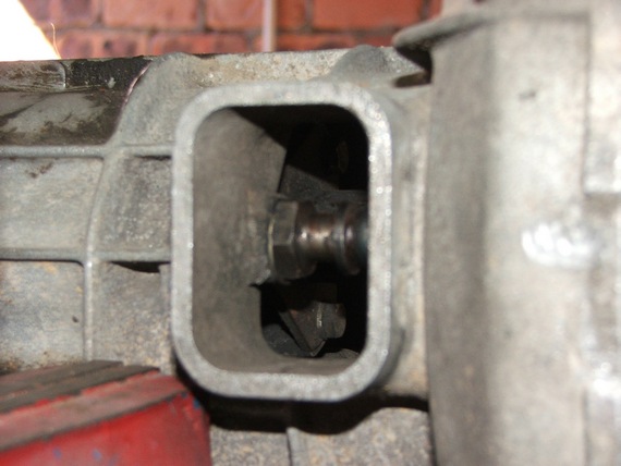

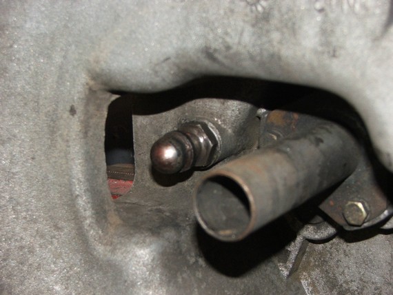

Thank you for such a quick response. I talked to him, and he had dificulty finding the locking bolt, is it hidden ?
OK here is a version on the theme.
If there is no locknut, then you have the original post unmodified. There is however a hex nut head to the post for moving it within the thread.
If the post requires enough withdrawal to allow a narrow locknut to be fitted behind it, well and good.
If not, simply move the bolt further out, mark this length and refitted it with some chemical thread locker.
See photos for post location.
If your mechanic still cannot do this, get another mechanic.
