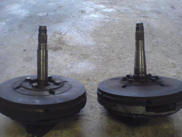

And clutches...
- Two types of clutches alfetta type always on the left
- DSC00756.JPG (57.67 KiB) Viewed 9019 times

What you're looking at there is a twin plate vs single plate setup
AFAIK all twin plates were mounted this way and all single plate were mounted off the clutch housing. All 2.0 TS were single plate.

I don't know whether you are reffering to photos or the blueprints. If photos then both cluthes are single plate - just different pressure plates. As for the strength, I was told by few "clutch - tuners" that the convex type (drawn) pressure plate are a performance feature on a clutch - greater pressure vs. pushed clutch. Again, that's what i've been told, but makes sense if you look at all those racing aftermarket clutchesDaniel wrote:What you're looking at there is a twin plate vs single plate setup

Alfa 75 3.0 uses single plate "pulled" clutch...
The 75 1.6 has a smaller diameter clutch as the others.
All 4 cilinder non-turbo cars use the "pushed" single-plate clutch. Only the GTV6, 75 V6, 75 Tb and Giulietta Turbodelta use the "pulled" clutch ( propably the Alfetta GTV Turbodelta used this also).
At first (Turbodeltas/ GTV6) this was a twin-plate unit but later it became the single-plate design.

PietereQ: That was the most comprehensive answer to a question I have ever seen, photos and factory diagrams. All GTV6 and Milanos I have seen have the slave cylinder mounted on the transaxle, which agrees with what you say.
