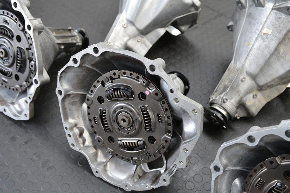

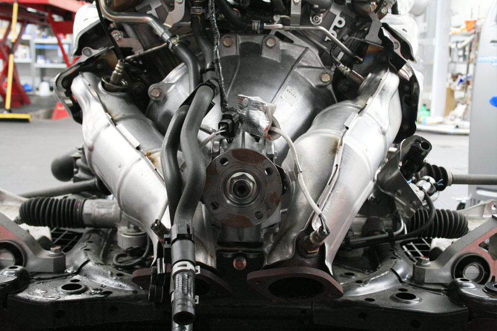

While sniffing around the net I found that the GTR does infact have a dampened tailshaft, with damping being provided by what looks a lot like a sprung centre that would be used in a clutch.
- LM-Bellhousing-installed.jpg (140.8 KiB) Viewed 6047 times
- LM-Bellhousing-closeup.jpg (122.52 KiB) Viewed 6047 times
