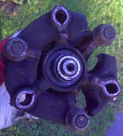

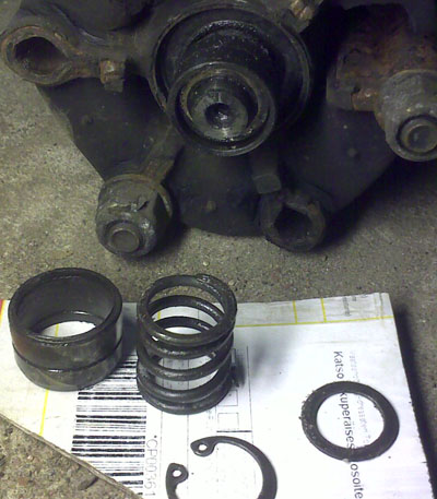

Since over revving the GTV a while ago it has a horrible noise at low rpm. Then at about 3k it goes away and the car works as normal. Took out the prop shaft yesterday and found the reason.
The parts in the lower photo I dug out from the hole in the flywheel. The guide seems to have broken in half.
Now I need to go shopping for some sikaflex to repair the donut with :twisted:
