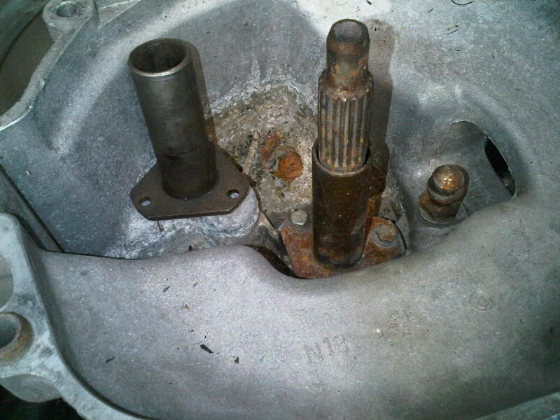

Hi, most chaps on this forum use the ts box on the 3.0 in their ra ce cars due to the ratios . By changing the a frame was a quick solution to your problem as you had it . Most of us just change the half shafts.
Make sure bleed nipple is on top when bleeding on slave. I use a short 7 spanner with a 24 to Hold it in position . You must undo clutch slave pipe to get bleed screw to sit naturally on top otherwise it puts tension in it. First let fluid just run through system to start then I depress fork under by hand to bleed initially until some resistance then only do I then use clutch pedal. Some times it can take you 5min sometimes 25 min and then some more ?
Just check you have the correct tension spring in clutch slave and also CHECK you transferred the guide shaft that the thrust bearing slides over from the 3.0 box to the 1.8 box other wise you find a horrible rattle about 10 seconds after you have let clutch out as thrust bearing moves around.
The guide shaft differs by 4mm from the 1.8 to the 3.0
see pic with the bigger 'tube'

I already had the car on the road before I received your reply. I hadn’t changed the Thrust Bearing guide, and yes it does rattle.

Put car in neutral let clutch out and wait 20 secs and you will find the rattle starts. It's a result of the thrust moving out it's central locating point then moving all over the show on the smaller shaft.
