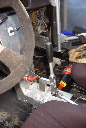

Tranaxle Fix
Just a small suggestion amongst the many quality tips provided already by others. Try going to "Our Cars"> Featured>Scroll to bottom of page. Select Blue Image of GTV. Check out the shifter conversion. You may get some ideas that you can use for your purposes. I can assure you the set up works very efficicently with short shift patterns and a narrow gate. For left hand drive configurations in a race car, the set up need not be placed on top of the transmission tunnel, it could be located on the drivers side. The key is reducing the length of the crank. Cheers, MD
Wow, that looks...incredibly complicated... :shock:
You did all that to shorten the throw?
So how much does that weigh you think?
Hi Mats,
The weight is something I never anticipated anyone would ask me so I didn't plan for a reply!
However, I would say that the selection mechanism itself would weigh approximately 50% more than the original set up but in real figures this would amount to no more than 0.5-1 Kg.
In practical terms, this is irrelevant because the benefits in precise and quick shifting are so good. In a race car you would not fabricate the dress covers etc so as I say, the weight increase is zip.
The characteristic of the changes is that it works better than a 105 series "stick-in-the-box" change. (to give you some idea.)
Mats, the reasons I did it are much more than just short changes. For a right hand drive vehicle, the location of the shifter is not optimum so the whole thing started from there and the quest to get it right just kept getting bigger. You know how it is, while we are at it ....
