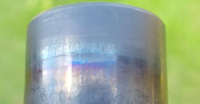

Found and fixed another problem....
After putting it all back together again I started it up for the first time to find made the most God awful loud screaming / squealing noise from the clutch area. Similar to nails on a chalk board but way louder. Depressing the pedal made no difference to the noise. Ran the motor for about 5 seconds or so. Out it all came again.....
Turns out I didn't know that the pilot tube for the release bearing to slide upon must be of differing lengths for single plate vs twin plate clutches, with mine having the longer (single plate) version bolted to the gearbox. Removal is easy once the clutch is out (3 small bolts), I shortened the tube by 12mm, this being just enough to fully un-shroud all of the gearbox input shaft spline length. Cleaned it all up to remove steel filings, reinstalled everything and it's perfect now.
The mismatch meant the center boss of the driven plate was touching the pilot tube at all times... activating the clutch effectively tried to force the boss to chew up the pilot tube end. The hideous screaming noise was moving metal on fixed metal. Photo of the center boss clearly showing wear and the pilot tube showing high temperature heat markings :-

heat markings :
wear pic3.JPG (26.55 KiB) Viewed 9704 times
