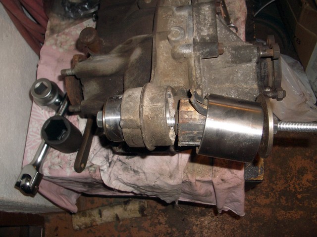

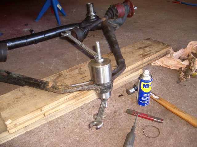

Kunta
Posts: 15
Joined: Wed Jan 26, 2005 2:56 pm
Location: Sweden
Post by Kunta »
I manufactured a tool for removing de-dion bushing and rear gearbox mount. I can also use it for inserting new ones.
Kenth Wiklund
75 3.0 Challenge
I just used a couple of large sockets and some left over exhaust pipe, took me about 30 minutes. :)
oh, I used a press naturally.
