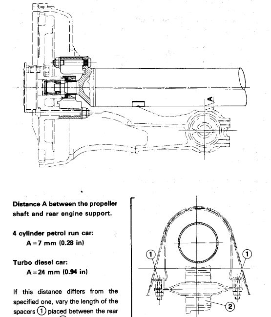

Hi everyone!
I found this pic on the 75/milano manual but it does not tell what clearance should V6 engines have between bellhousing and propshaft. Does any of you know the correct clearance?
I'm really having hard time trying to get my milano running without vibrations. It's originally TS but has now 3.0 taken from 164 and now with single turbo install. I have renewed all guibos and bearings on the propshaft and had it rebalanced but still it vibrates. I think it must be misaligned. Any ideas how i could fix it? Thanks.
-Marco
-Marco
