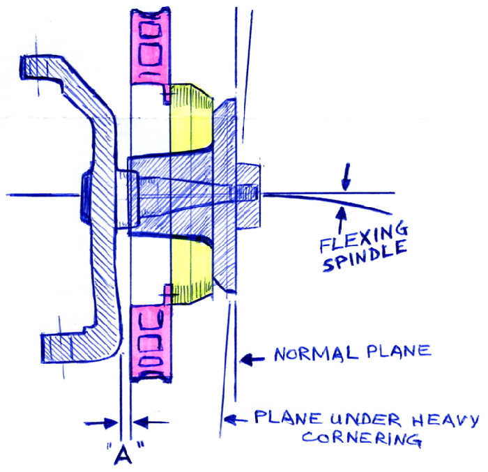

This is for anyone who wants to build a big-brake set and takes track driving seriously. I thought a drawing would be more eloquent in describing the problem. After 70-odd hard laps with my new brakes, I noticed two gouge lines about the middle of the inside surface of both discs, the left one more pronounced (more right turns). The corresponding upright areas were also marked. Dimension A in my car is 4mm!! You understand this means the spindles flex quite a lot when heavily loaded-and I have -2.5* camber!
Moral of story: design your set with about 6mm of clearance! Flex depends on weight of car, tire adhesion and cornering speed.
- I have colored the bell and part of the disc for clarity.
- File0157a.jpg (171.85 KiB) Viewed 21044 times

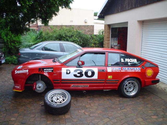

Damn,cant find those close up pics now.........Both these cars heve the big brakes..the 156 even bigger that the gtv...From the wheels you can see I had very little space for the calipers(you recognise them?)cause of the split rim bolts-so the discs were pushed far back almost against the spindles..Ron has also thrashed this car heer,,no touch..

Jim,Thinking bout this...your tire is going to take all the flex...trhe spindle is staying right where it is,no flex...MICKE?????????
Oooohhh....how I'd like you to be right! I took the wheel out, the pads and then the caliper (no sweat, two 19mm bolts) no obstructions anywhere unfortunately. It IS the uprights, they're scuffed right next to the disc 'grooves'. Well, 1400kg take their toll. Now you know why certain models had 31mm (or is it 33?)spindles instead of 29! I will do a 1:1 scale drawing with exact measurements to see exactly how much this flex is; I'm really curious. Thankfully the spindle is forged steel but I don't know how much of this it can take! If we look at it as a system, we have other items too, subject to elastic distortion (not permanent): the bearing and the hub. Also, the bigger the wheel, the higher the exerted torque is on the system during cornering.
All I can say is this was veeeery disturbing!

After careful and hurting thinkabout it can only be the spindle, shaft or the bearing. The spindle is the only reasonable answer I think.
Someone do a FEM analysis of the part please. I'm really curious even if it's not likely to be a problem for me running street tires on my 900 kg beast and additionally a shortened Spindle (= less flex)
BTW! More clearance is definitely NOT the answer. Just think about your carefully set camber.

I can't see the thick black vertical part of the upright flexing significantly or at all (although there's no such thing as zero flex in these things) Can't do much more about the camber either at this point; this phenomenon should not be happening at all if things were properly sized (= thick spindles!) I judge camber by tire temps and wear - doesn't everybody?

I believe you might get flex in the upright ,not in the actual spindle though...It lies in the wrong plane??

Barry, the reason I say spindle flex is I can't imagine the huge upright flexing itself although at this point nobody can rule anything out. I don't have floating discs, I ain't rich yet!
Another thing I have to account for is temperature effects. I have measured 120*C on the wheel between the studs. The alloy bell was off-scale for my laser temp gun (Over 250*C), forget the discs! The calipers (alloy) are also mounted on hefty alloy brackets....lots of variables there! Going sci-fi here, I'd love to see this system operating on a big lathe...that would tell a lot about temp effects but no flex info.

But 4mm due to flex alone seems very high for something which looks pretty sturdy. Perhaps it has to do with the expansion as well, as you said? That would make more sense. So basically you have a few components to the equation.
Disc expansion
Bearing play
Spindle flex
BTW, isn't there an run-out (wobble) tolerance allowed for the whole disc/bearing assembly?
My guess is, this is not just a case of spindle flex alone.

I'm not so sure if it does matter how much static camber you set. The highest force will be present during cornering and if the camber is set right you will use you complete tire width. And then the load could be assumed somewhere in the middle of the tire...... I run 4 deg!
As a system three things will happen:
1) your bearing axle will bend.
2) your upright will deform into an S-shape. (torque implied by the bending axle)
3) bearing deformation, which I think is neglect able.
Jim. do a good detailed drawing with sizes and we will do a fast sum on the matter. I still think 4 mm is much, but that is a gut feeling
