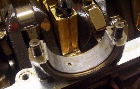

I found a photo in the 164 section of the AlfaBB. This photo shows what the big end bearing shells looks like - very similar to what I saw in our GTV6.
Still doesn't explain the noise I am hearing...

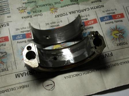

So, still trying for a diagnosis, I dropped the lower half of the sump (again) and removed the oil pump to get a look at the #1 & #4 rod bearings.
It appears I found a problem. I am hoping it is the problem.
(that is a reflection going across the bearing shell)
- rod bearing #1 sm.jpg (42.25 KiB) Viewed 11218 times
- rod bearing #4 sm.jpg (39.63 KiB) Viewed 11218 times

They do look worn, is rod offset ok?
