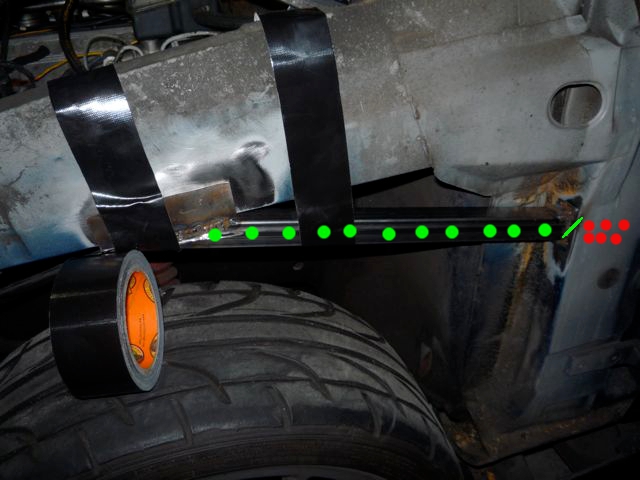

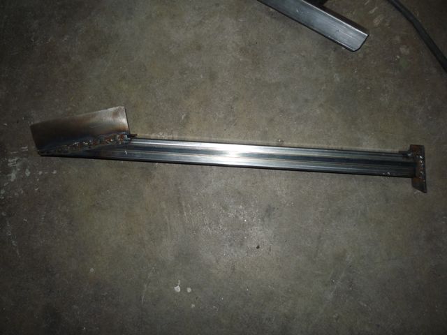

Some updated pics of inner fender brace. I think a brace is a bad idea for a full time street car, you will compromise the crumple zone. But for a 80% track car, not too bad of an idea. But for a race car, don't wast time with this, go with a full cage which extends into the engine bay.
I intend to only put a few spot welds between the brace and the body of the car in case I don't like the idea and decide to take it off.
Opinions?

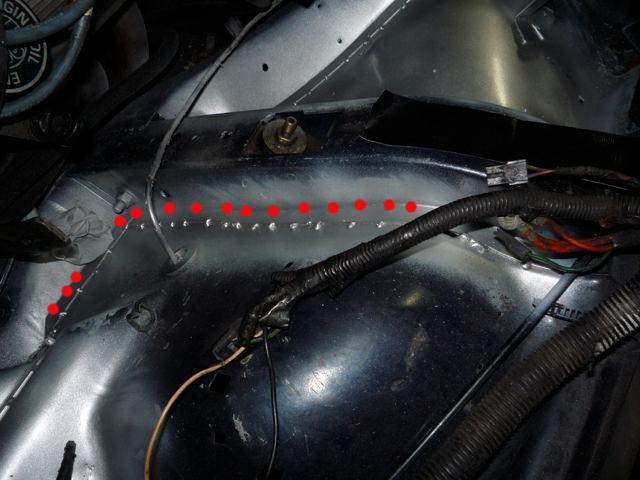

Z, hate to say it but your spot welding isn't really effective.
When you really want to add stiffness, you need connected the sheets together without a bend in the sheet. And make it look like a square section tube.
So weld as close as possible to the vertical sheets metal. Best would be, mill some small holes from the wheel side of the fender and weld from there, which is pretty difficult to do.
Easiest/practical to weld, melt though the upper sheet as close as possible to the bend, make sure the melt goes through the lower sheet.
Re: Spot welding engine bay
Point taken.
But as you said it is difficult to do and all the photos I see of is people seam welding the way I did (except I spot welded). I'm afraid to seam weld, might warp the sheet metal as it is very thin. If seam welding I should ask a better welder to do it, not me.
I think what I can do is from the wheel side is drill a few holes 1/2 way, till it hits the other sheet metal. Maybe 5-6 spots on each side of each shock tower should be ok? Then spot weld and melt the 2 sheet metals together.

The spot welding done by alfa is really bad, so everything you add helps :D
I think what I can do is from the wheel side is drill a few holes 1/2 way, till it hits the other sheet metal. Then spot weld and melt the 2 sheet metals together.
Actually this is what I meant, it is very easy to melt two sheet together like this. The hole drilling is the hard part. Warping isn't an issue if you take it easy.
What do you think about the brace?
First of all, same story as the seam welding. Try to let the (vertical) side wall of the square tube align with the vertical sheet of the a-pillar.
Best would be to let the tube protrude into the a-pillar. And weld it onto the sheet it hits, plus around the hole you make in the a-pillar. Also spot weld the tube to the side wall (red dots).
To save some weight you could make some holes (sort off like the green dots) in the vertical wall off the square tube.
Hole diameter ~ 60% of the inner square diameter of the tube and 3x hole diameter (hart to hart of the hole) pith. But make sure you don't have a hole underneath the sheets of the shock towers.
