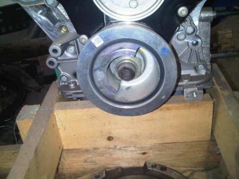

I took a pic today of both my gta engines front pulleys and one has mallory added and the other is drilled. Shows there was no standard on the gta unless the mallory fell out on my other motor . One motor is brandnew still in crate , the other is in my sportwagon.
Re: 75 or 164 Motronic crank pulley?
Check these two pics of GTA pulleys.
- gta in car.jpg (82.5 KiB) Viewed 10486 times
- gta crate.jpg (26.71 KiB) Viewed 10486 times
