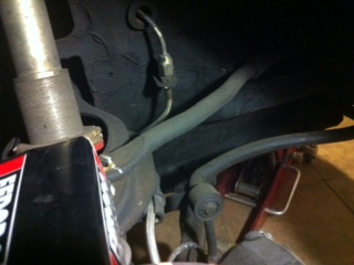

4) I also got them to do Braided hoses - Pic attached - I recommend that :wink:

Braided hoses
Braided hoses
Braided Hoses.JPG (31.13 KiB) Viewed 18410 times
