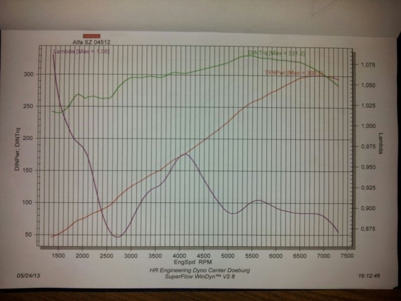

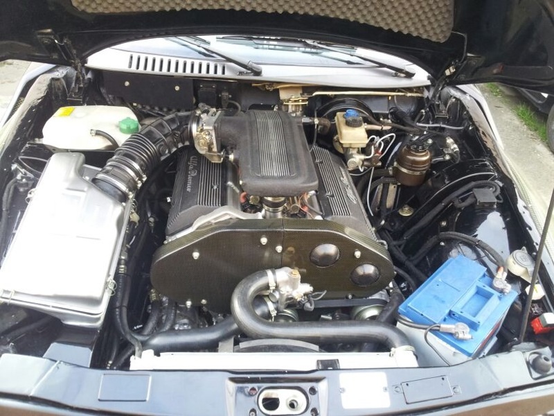

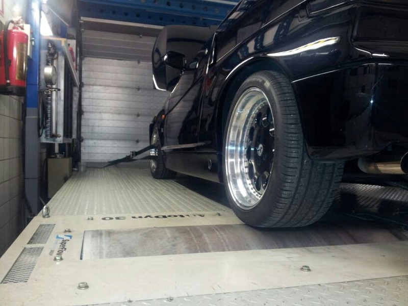

Finally the car is ready!the engine is a standard gta engine with bigger (Greg Gordon) injectors and adaptronic ecu
Gives 300 horses and 330 Nm.
I'll pick it up next week

Wow!!! Beautiful and powerful.
I'm guessing on your tuner's dyno, with 11.2:1 compression, 10mm cams, long tube headers and bellmouthed modified plenum, Autronic SMC, I can expect 330 bhp?

That is the most beautiful engine I have ever seen I did some thing similar for Jose (powermods911) street race car but your one looks way better
