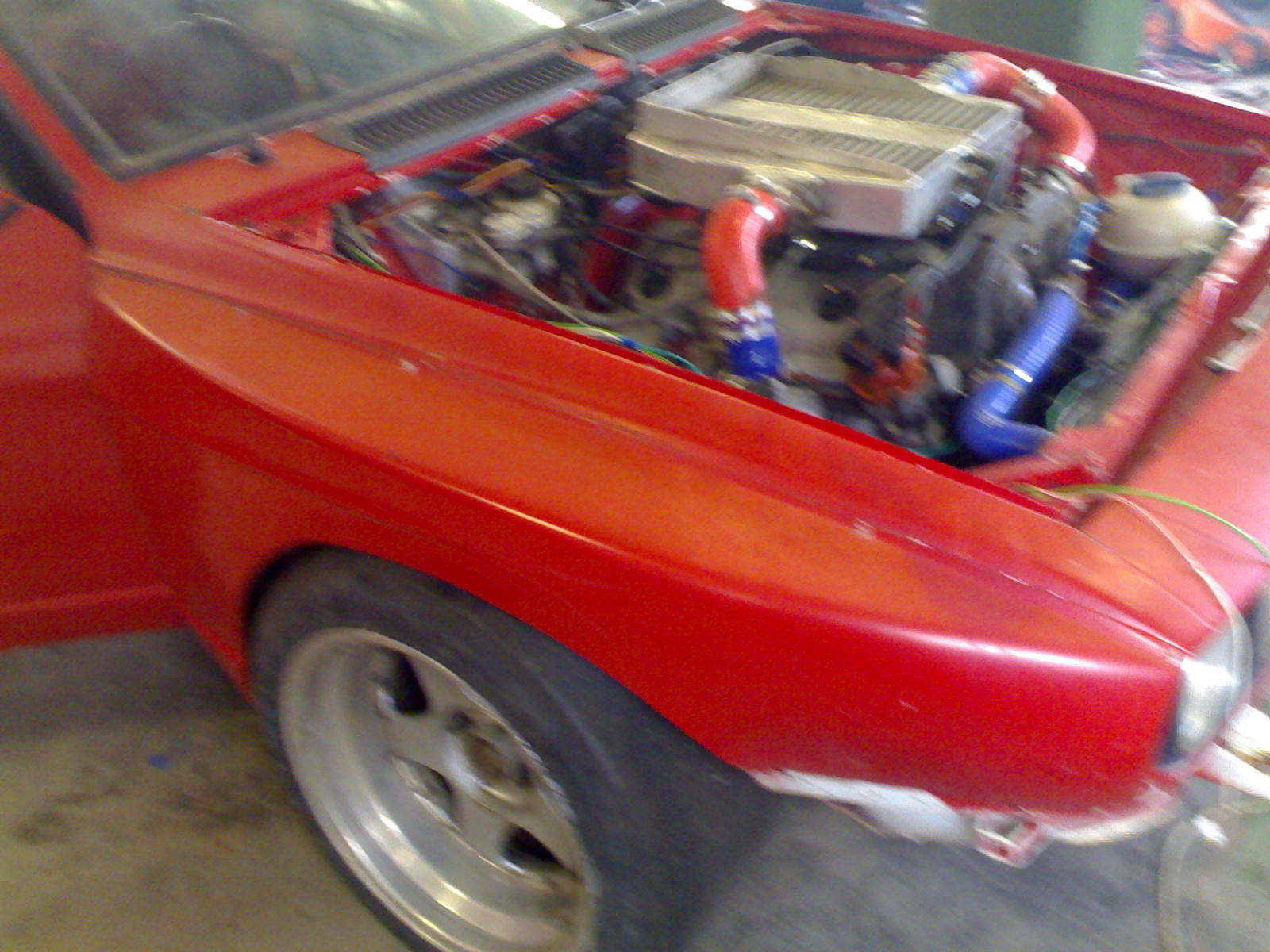

- Almost finished......
- PowerMods911 GTV.jpg (100.94 KiB) Viewed 11900 times

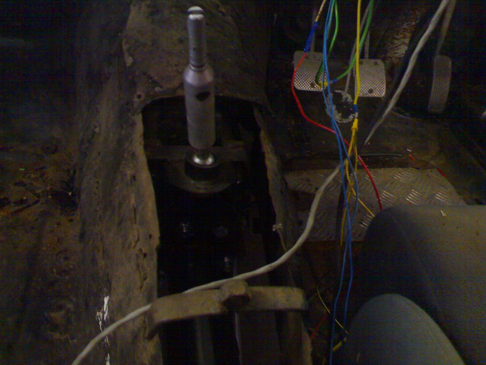

- Getting the front monted gearbox and gearlever installed.
- 07042007(002).jpg (204.94 KiB) Viewed 11903 times

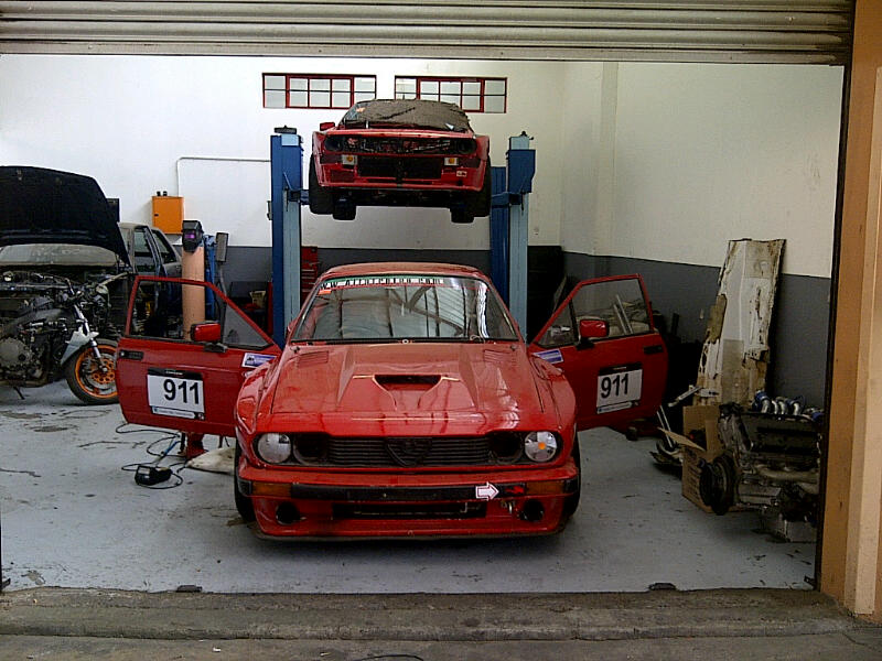

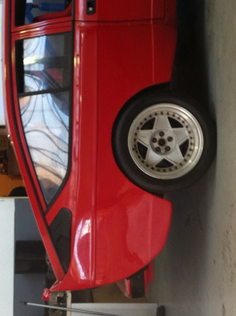

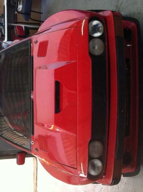

Race Car before we added race stickers
- GTV911 Pic5
- GTV 911 Race Car before stickers 005.jpg (88.79 KiB) Viewed 11781 times
- GTV911 Pic4
- GTV 911 Race Car before stickers 004.jpg (89.72 KiB) Viewed 11781 times
- GTV911 Pic3
- GTV 911 Race Car before stickers 003.jpg (85.86 KiB) Viewed 11781 times
- GTV911 Pic2
- GTV 911 Race Car before stickers 002.jpg (84.41 KiB) Viewed 11781 times
- GTV911 pic1
- GTV 911 Race Car before stickers 001.jpg (52.74 KiB) Viewed 11781 times

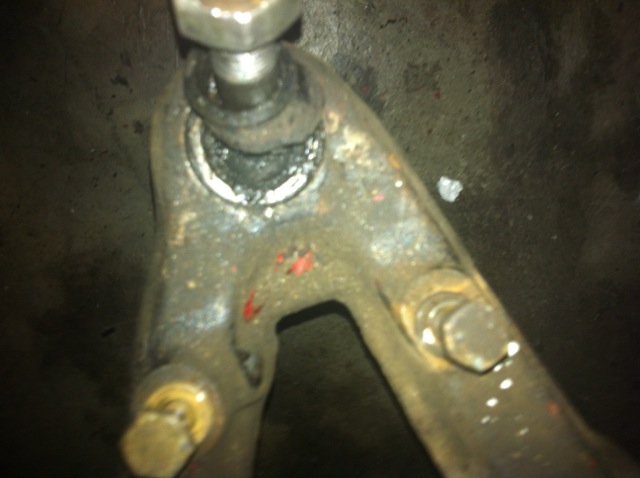

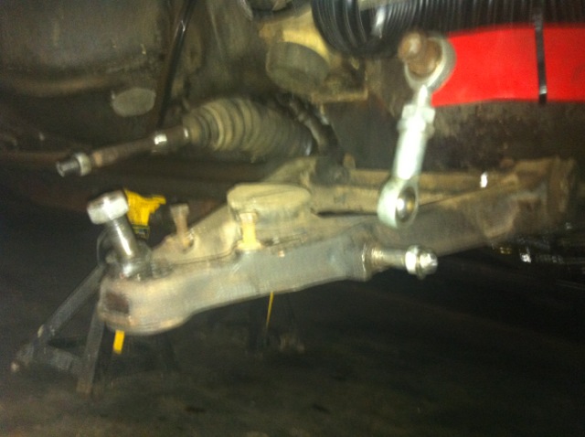

Here are pics of the upside down ball joint Kevin refers to as being loose with 20mm play.
- close view of ball joint
- GTV Race Car Suspension 008.jpg (66.8 KiB) Viewed 11736 times
- Driver side lower control arm with "upside down ball joint"
- GTV Race Car Suspension 003.jpg (77.16 KiB) Viewed 11736 times

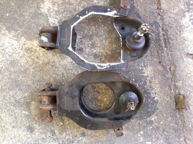

- bottom view of the upper control arms. As I'm fitting coilovers I needed to open them up to allow the springs to fit in.
- GTV Race Car Suspension 002.jpg (134.41 KiB) Viewed 11733 times
- Top view of the upper control arms.
- GTV Race Car Suspension 001.jpg (79.11 KiB) Viewed 11733 times

What kind of balljoint did you use for the upsidedown conversion?
- Posts: 77
- Joined: Sun Mar 17, 2013 11:12 am
- Location: South Africa - The VALE
Re: PowerMods911 - GTV6 2.8 TT - Race Car
I bought the car with the mods, so I'm not 100% sure. I've been told it's a chevy 2 ball joint. Went to GM motors with the sample and true to form they couldn't tell me. I suspect it's a 1977 Chevy 4100 or 4200 ball joint. I'll keep enquiring, there are a couple of suspension specialist shops in Pretoria that I'm hoping will be able to assist me. Even though there are no markings or codes on the ball joint they should as I have the sample to show them.

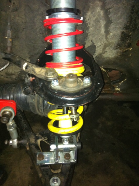

Kevin, yes the entire front suspension is off, as is the steering rack. Started fitting the original 2.5 GTV suspension on. So far only done part of the left. Fitted the left lower control arm, went well. Then onto the top contol arm, what a mission. Couldn't get the old one off. Eventually had to take the left side turbo, and exhaust down pipes off. The upper contol arm bolt still wouldn't budge, after some major persuasion it eventually came off.
Fitted the top contol arm and the coil over shock. Will post pics later

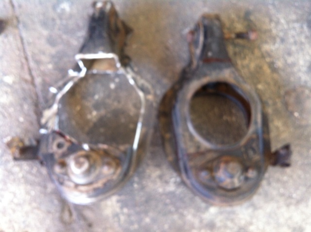

- Cut off the stoppers to make space for the coilover springs
- IMG_3853.JPG (106.08 KiB) Viewed 11561 times
- Entire front suspension & steering rack taken off
- IMG_3852.JPG (112.07 KiB) Viewed 11561 times
- Left side coilover sping, LCA, TCA refitted. Note I've kept the torsion bars, reconsidering taking them off.
- IMG_3851.JPG (100 KiB) Viewed 11561 times
