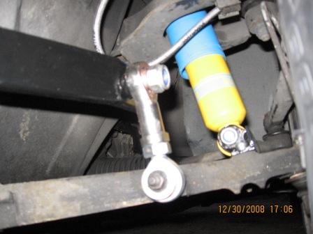

Thanks Kevin. Give me a day or so, because I have moved abroad (Holland) and I need to look for my backup disk with all the photos. Will post photos of adapter I made. As far as A arms go, yes I did enlarge the opening since 160N springs require larger shock bodies, and 2,25" diameter springs

Kevin, I hope this clears it a bit. Mind though there are some errors in the drawings as i remember, but it is just good enough to give you an idea i guess.
Re: GTV6, ex Zender, turning into a racer
Thanks that a real help as my mate has these shocks and wanted to see how you did it .

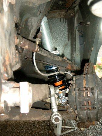

Kevin an extra tip:
To get some more stiffness in your bracket use a l-piece or a square tube as base material for the strip that is mounted onto the lower arm.
But when using a thin walled tube make sure that the you insert bushes at the mounting holes towards the lower arm. So that the interface point itself also is stiff enough.
Square tube ring TS
Square tube ring TS
L-piece for daily ts
