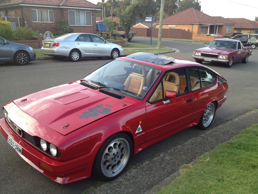

First off, the fuel smell is ridiculous! I've got monday and tuesday planned to take apart the fuel system again and replace all hoses and check the vapour canister, hoping to have a result.
But driving her just gets better and better. The front end no longer seems to load up and compress to the point where it seems to "fall over" on the outside front... the steering stays light, I can get on the power and just drive through corners... but here's the catch- it steers so much better (and I'm so out of practice!) that I don't trust myself to be able to catch the tail and drift it right now... I will edge my way into this on the track.
My little 2.5 screamer is getting better with every drive. She is obviously happy to be back on the road. Got some custom plates. They weren't my first choice, but they suit the car... they're just a regular no. plate with letters first, numbers second. They contain a "6" and the letters "GTV", so I'm happy
Interior pics- it almost looks factory, with a subtly modified taste to it, IMO. I love it.
My girlfriend and another friend (female), both interior designers by trade, had questioned my scheme.... and both have given it the nod.... not that is was ever "my" scheme!
Tomer's material adding such an awesome finishing touch... I'm happy to have it looking so factory!

Well done on completing this project . Really tastefully done . It should get featured in your Alfa club mags as its pure Alfa Romeo with no other aftermarket accessories from other makes on . Now you need to keep it in a safe place .
