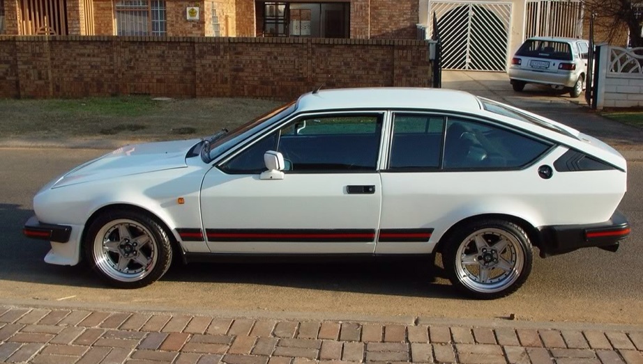

Compomotive made for Alfa GTV 3.0 in SA . These gave better cooling than the mesh type compos in racing . That's what it found anyway . This GTV 3.0 has much wider dishes than the factory 7.5 j

don't you have problems with rubbing the tires against the firewall/bulkhead, especially when steering?
when i had my speedline mistrals fitted it rubbed quite bad

Those speedlines look good . Need some more light in pic on the wheels if you get another chance to take a pic to show them off . On the 15" they just touch inside arch on dust cover but on 16" you have to do some surgery by heating and knocking back the seam by 15mm . Got be carefull not to set the car alight inside though .

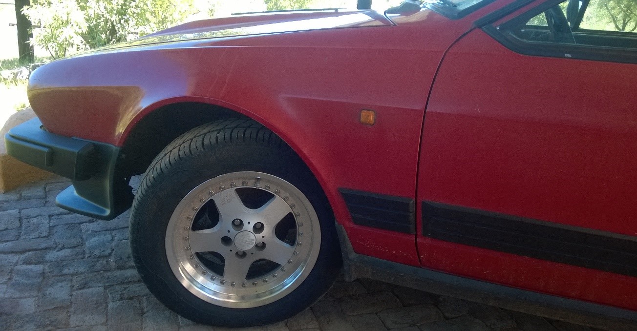

here are the rims on mine, i think they're called Heroes racing or some such, can check for detailed specs if anybody is interested. theyre 15" by 195x215, i think. :oops:
'83 GTV6 stock with Wildcat exhaust system

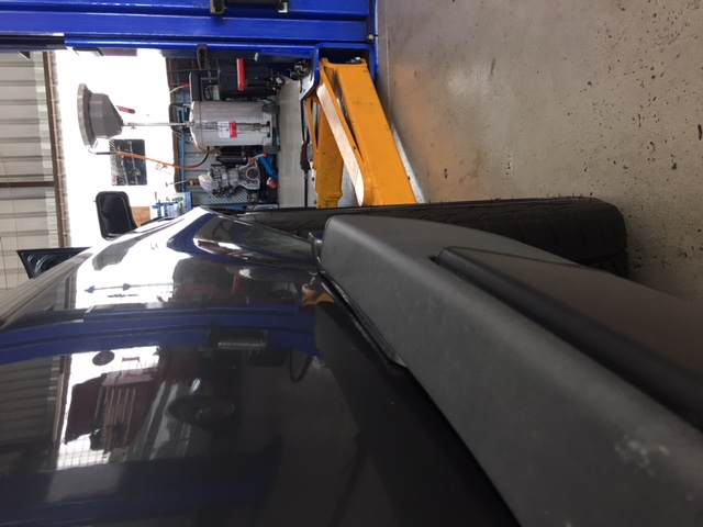

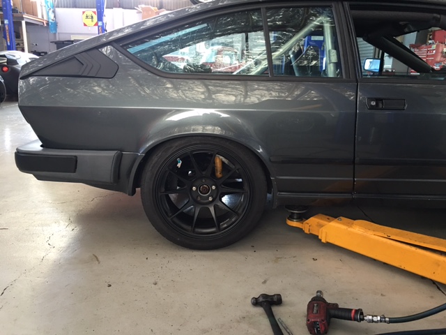

Alfaaa1 I think with very careful offset you could make them work. 265 will fit but will be tight. I've got 17x9 going on all four corners but it takes a few sneaky mods to get them in the front. 245/40's all round.

Alfaa1 both front and rear will be dependent on wheel alignment specs and obviously ride height will play a roll.
Wheel offset around plus 40 in the front. And with 265's I'd guess around plus 25-30 on the back.
I have +22 with 9" wheels but also 2 deg neg camber on the rear. Without neg camber you my want to bring them in a little maybe +30

They look like Rota Titan.
105gta.
Posts: 72
Joined: Fri Oct 23, 2015 4:15 am
Re: PICTURES-Different wheels for Alfa`s.
Post by 105gta. »
Hi 75evo, yeah they are Titans.
